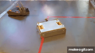

If someone brings this, I’ll be concerned.
(The black one is mine. :slight_smile:)
Otherwise, defensive bots have been doing fine for as long as I can remember.
