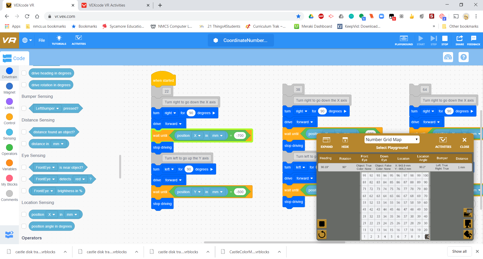

Location Sensing not working
After having trouble using location sensing in my own code, I loaded the CoordinateNumber3 code from the teacher’s VR Challenge Solutions. The VR robot is not sensing location with their code either. Has anyone else encountered this? Any fixes?
= is not the best logic here because it is unlikely to ever read that exact value. Try using > logic instead.
