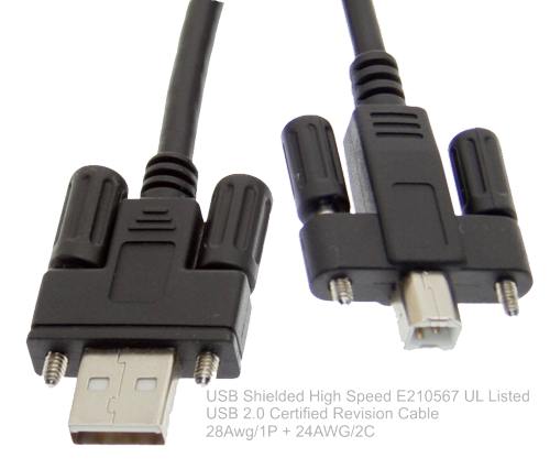

Locking USB connectors. Ex: [https://www.coolgear.com/wp-content/uploads/2013/01/sc-u2mab-3.jpg
Maybe allow modification in the competition rules to allow more flexibility with securing electrical items.](“https://www.coolgear.com/wp-content/uploads/2013/01/sc-u2mab-3.jpg”)

Pressure on the USB connection can wear that out too.
I would agree that it would be nice to have better connection ports, but until then we have been using the battery extension cables to ensure that the female ports in the cortex and the expander are not damaged. its easier and cheaper to swap out a $5 wire than a cortex or expander, especially in the heat of a competition.
