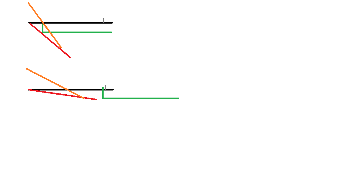

I don’t know exactly what you have but this is what I’m thinking:
Black is the slides
Green is the plastic slider
Orange is the rubber band
Red is a steel C-Channel or L-Channel that is the lock, which is on a hinge.
When the green slider goes forward, the C-Channel or L-Channel goes up and engages, acting as a lock to prevent the green slider from coming back.
Untitled
I hope this can be useful but I seriously don’t know what we are dealing with. But this is the solution I can illustrate from what you have given me.

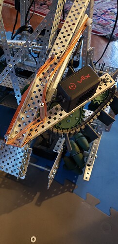

20190910_190815 is what I’m dealing with. Sorry for the subtle ideas
The screw is the pivot point with a locknut and if I move the arms in further it will get in the way of the tray. Currently, it can stack 4, but it doesnt have enough compression to push up the 4th cube.

From what I can tell though, some small piece like a small C-channel, or a spacer or standoff on the end of the linear slides might help with compression.
try adding more flaps to the intake maybe.
The rubber band on the right of the pic seems to be pulling the intake open. Try removing that.

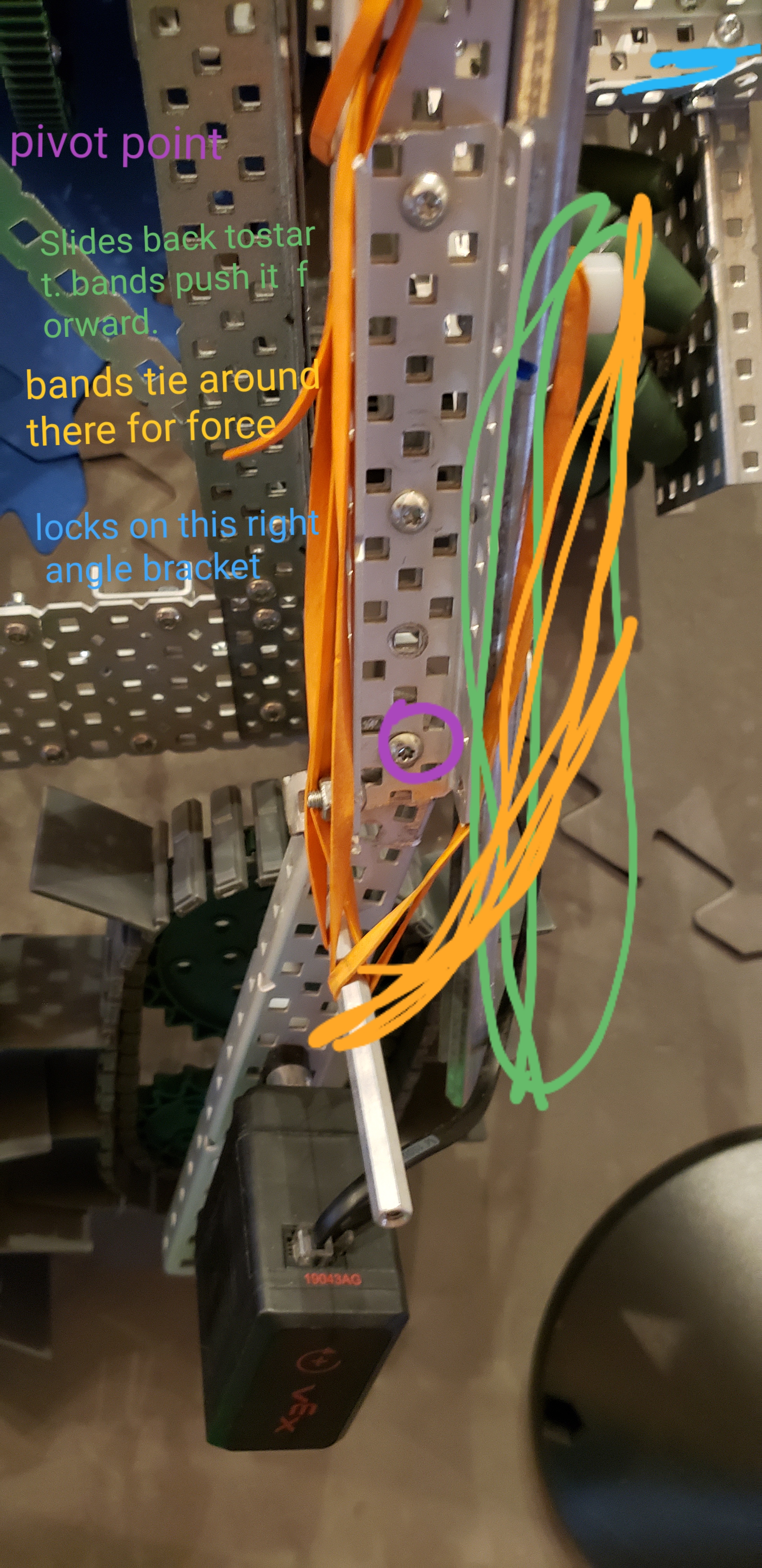

@64540A @Railgunawesome @CarCar @2775Josh @ThirdDegree The rail is the type that slides on the other rail. So it slides back at the beginning of the match with the roller arm blocking it. When the roller arm flips out, the rail slides out to block the rollers. These two images should explain it20190911_071000 20190911_070026

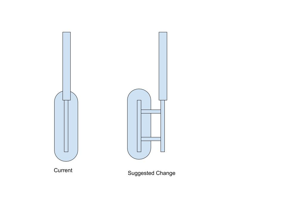

It looks to me like you could add more flaps(for more compression). You could also move your rollers to the inside row of holes on the short c-channels. However, you would have to put your bearing flats on the outside of them since they dont fit back in there very well.
The concept of your mechanism shows that the rigidity of your rollers is based on rubber bands, and that your roller arms can flex outwards, losing traction/compression. If you search the forums for locking mechanism, there are a couple out there already that would hold those arms in place and minimize those losses.
