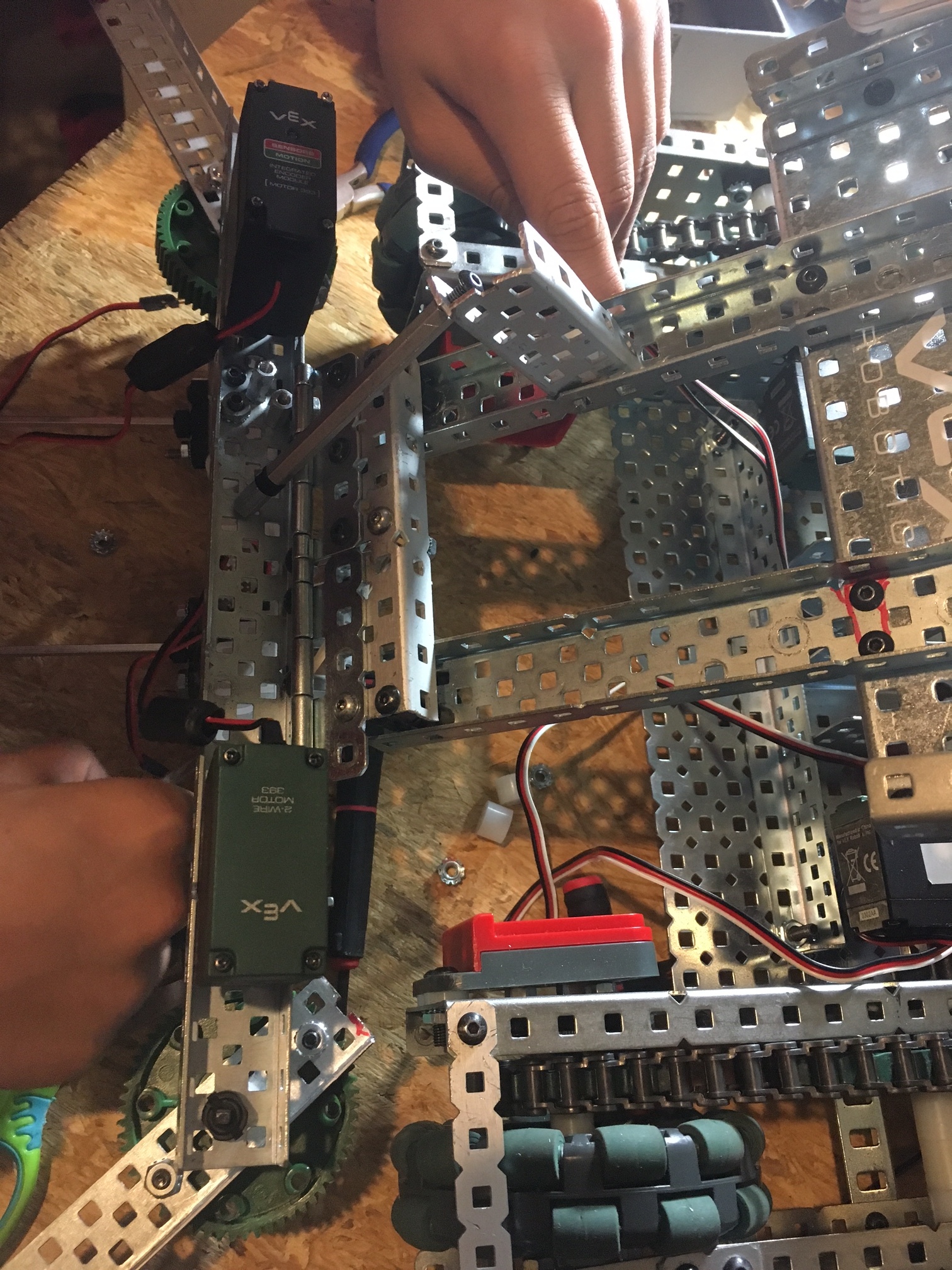

Hey guys, I would really appreciate it if you could help us with a locking mechanism. I have a picture of our claw attatched to to the post. We have tried all of Infinity Minus 1’s locks, but could not get them to work.
Do you really need a lock? Can you load up your claw with enough rubber bands that it cannot return back up and devise some way to keep the claw up at the beginning of a match?
That would be helpful, but the problem is getting them to work with our current mount.
@mwang We can try that, we do use rubber bands, but I am assuming not enough to keep the claw up. Thanks!
We use about 10 rubber bands, which keeps the claw down easily. We could use 6 with the same effect but went a little overkill just in case they break in a match.

@mwang17 We are using about 8 rubber bands, but how do we keep the claw up in inspection?
We have small hooks that hold it up. When the claw moves it unhooks itself and flips down.
@mwang17 Do you use #32 rubber bands or #64, cause we tried with 10 #64’s and it isn’t working too well, we also adjusted tension.
@wesleywong We would, but there is an incredible lack of aluminum in our school.
#64 rubber bands. Make sure there is an ample lever arm for the rubber bands to stretch over, or it won’t do very much.
@mwang17 Ok thanks, we tried it and it works now. Thanks for your help!
