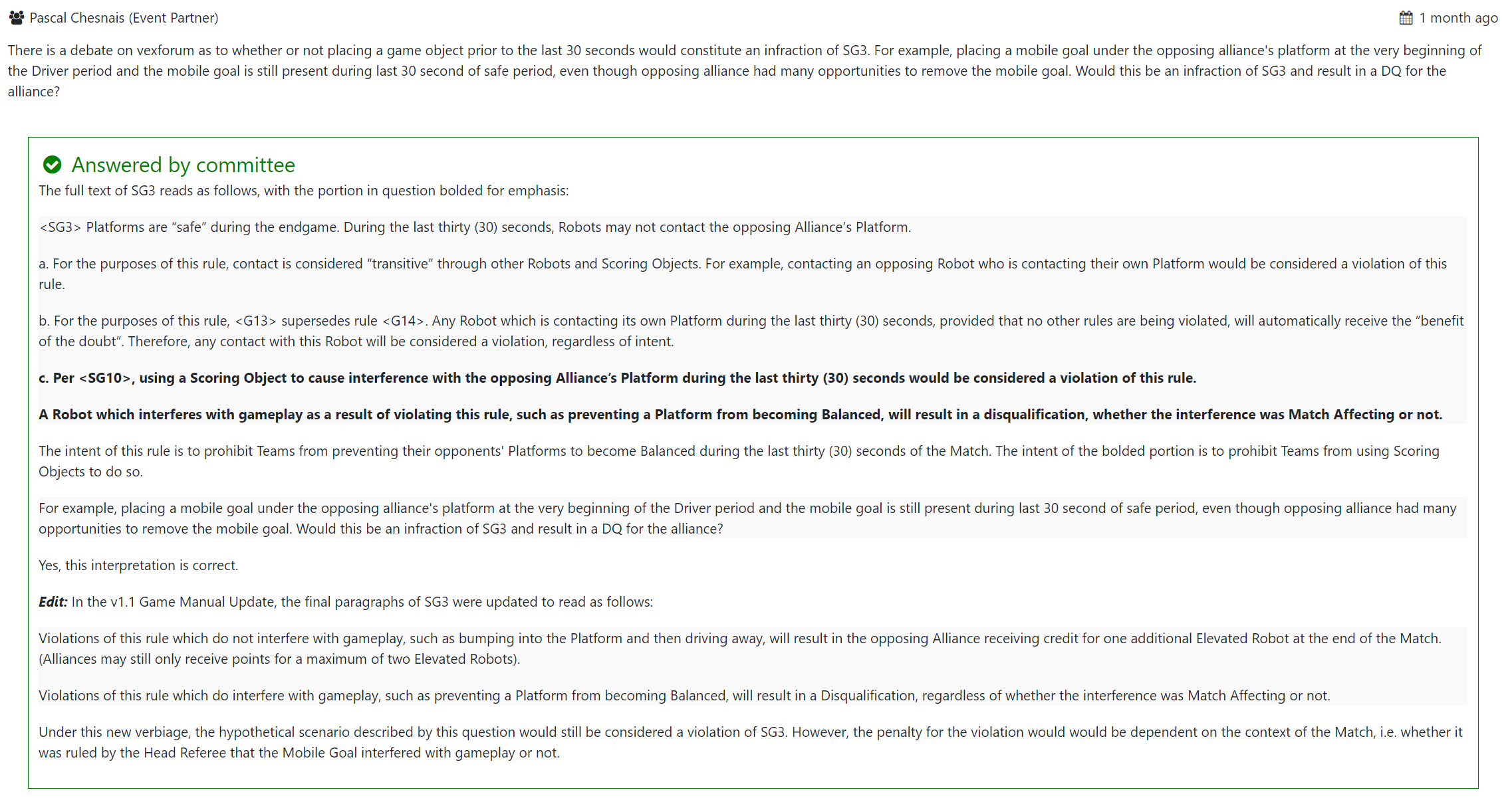

This has been addressed in the Q&A:
https://www.robotevents.com/VRC/2021-2022/QA/813
https://www.robotevents.com/VRC/2021-2022/QA/803

As this idea was raised in our workshop and resulting conversations and Q&A referenced above, the conclusion is that it does not make sense to deposit a mobile goal or any item that will be left behind under the opposing alliance platform to be present in last 30 seconds which according to Game Manual and Q&A will result in a DQ. No question about it. The burden lies solely on the alliance robots to remove it before last 30 seconds of match.
Use these constraints as needed to develop game strategy.

This is clearly addressed as one of the comments pointed out:
Intentions are not a factor, only whether it interfered with gameplay (though still a judgement call)
