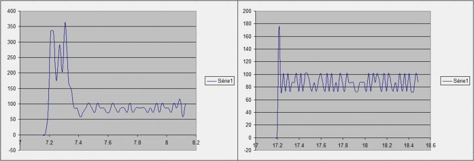

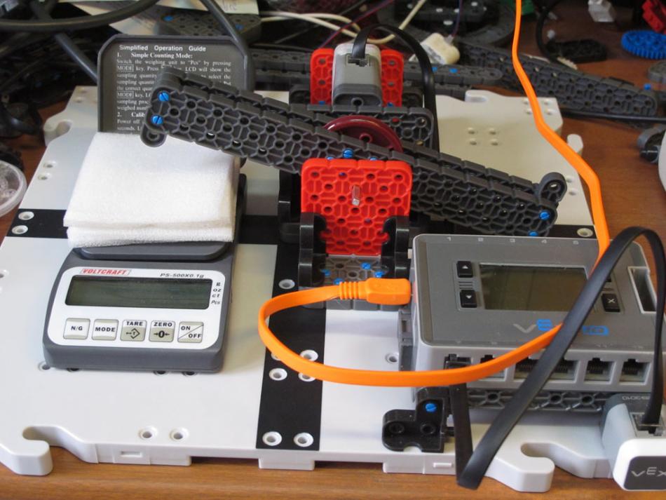

I was curious to see the current limit in action, so I built a small contraption, consisting of a swing arm that press on a scale to measure force (with some foam in between to smooth strong impact).
On each run, I activate the motor during 1 second each time I press the touch sensor. Strangely enough, the first stroke is much more violent than the following ones. This is confirmed by the current curves, showing much higher currents on the first activation (see the curves attached). I don’t think it could be caused by any thermal problem since the test is fairly short and the current limit low (100mA). Any idea of what can cause this behaviour?

The motor current limiting mode of the VEX IQ Smart Motor is primarily set to cap the steady-state current draw, which in term limits the maximum torque output from the Smart Motor. This torque limiting capability is best described as “eggshell mode” - as in you want to pick up eggs without breaking them.
During brief transient conditions, the current measured by the Smart Motor can appear to exceed the limit that it is currently set to. This can occur during normal acceleration (when it can very briefly exceed the limit), but also can be reverse current from back EMF of the motor. This current from back EMF can occur from instances such as if the motor hits a physical hard stop and slightly bounces back. The current sensor inside the Smart Motor is unsigned, so it cannot differentiate between normal current draw, and reverse current from back EMF from the motor.
From the graphs shown here, it would appear that on the first iteration of the 1 second test loop, the Smart Motor is taking up all of the backlash present in the system until it hits the hard stop, then in the subsequent tests the backlash is pre-biased such that at approximately 200mm in every test the motor is hitting its final hard stop (the force plate). Afterwards (~380ms on first test, ~250ms on subsequent tests), the motor current then settles down to the specified current limit where it remains.

Here is a photo of the setup:

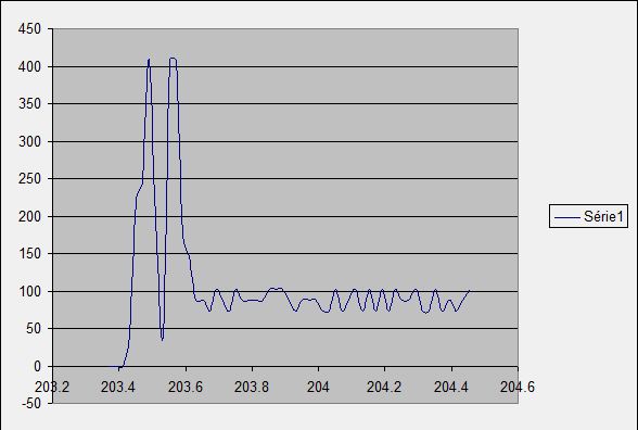

As you can see the lever has some travel before hitting the foam. Here is a new curve obtained in “normal” run (not the first one), we see a current of about 50mA during arm movement, then a spike at 200mA when we hit the foam, and a settle below 100mA after. The arm is manually moved back to starting position before each attempt.
This is to be compared to a first run after starting the program where current reach 400mA during arm movement, and again - I guess - when the foam is hit.

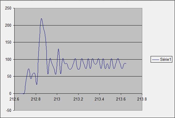

To sort out things, here are the curves obtained with arm placed initially on foam, here the spike (weaker) occurs immediately:
…but lasts a much longer time during the first run.
It’s difficult to see the pushing strength during first run spike because my scale doesn’t have such a fast response time. But I have recorded “weight” in the range of 200-250g during first run, while it keeps below 80g in following runs.
