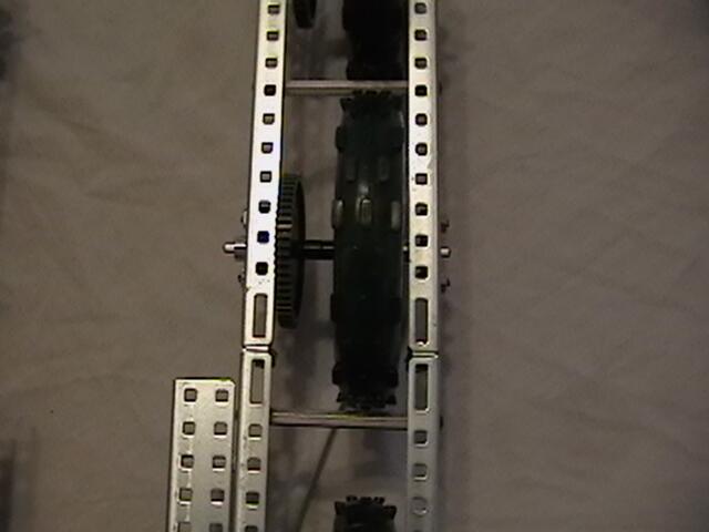

the 3 inch shafts don’t work unless you are REALLY conservative with spacers and you space it perfectly with a threaded collar inside, and push the axle on the inside of the bot so you can barely see it. You should have barely enough collar space at the other end of the wheel, but you’ll have to use a bit of luck.
VEX should get longer shafts. I think that the 2 inch shafts are pretty much useless.
These are my custom 4" shafts… I used the 3" “partially threaded beams” between the rails.
The 2" shafts can be used for the Idler Gears and such…
