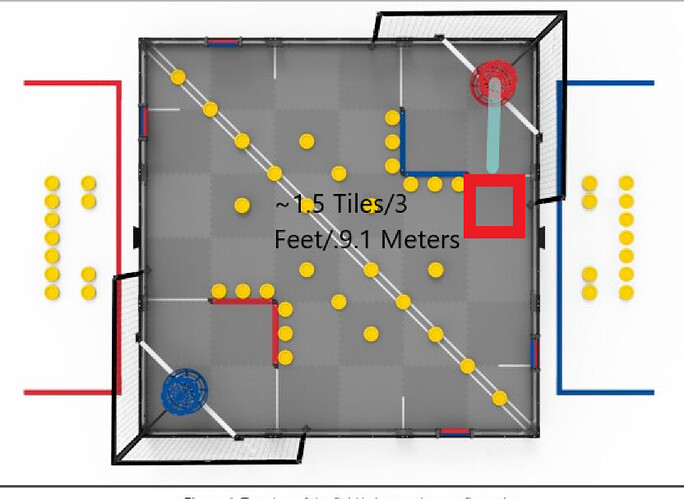

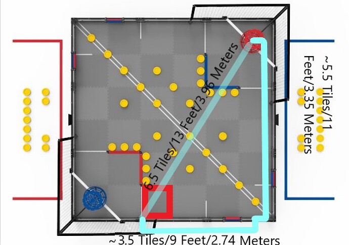

I wanted to calculate how far our flywheel needs to shoot in order to land a shot from the farthest reasonable shooting spot on the field. Here are my rough calculations:
The red square is the robot position, the light blue lines are the measurements. In theory, you need to shoot a disc high enough that when the disc reaches 13 feet, it is above 25 inches (the bottom of the high goal). I just thought that I would share this with everyone that is doing some early season testing on flywheels. Thoughts?
I don’t think it’s practical to shoot from that far away so you shouldn’t design around it
Here is the shortest reasonable distance if anyone is interested

You can create an arc with the 13 foot line, which covers the corner tile of the low goal, and I think people will probably only be shooting from that tile so that they don’t hit the opponents high goal with discs (unless it could be used to knock them out?!?!?)
In NBN teams built for a 17ft throw (diagonal of the field perimeter). You can always dial the motors back if the distance is less and I also suspect that the goals have a reasonable amount of stopping power.
