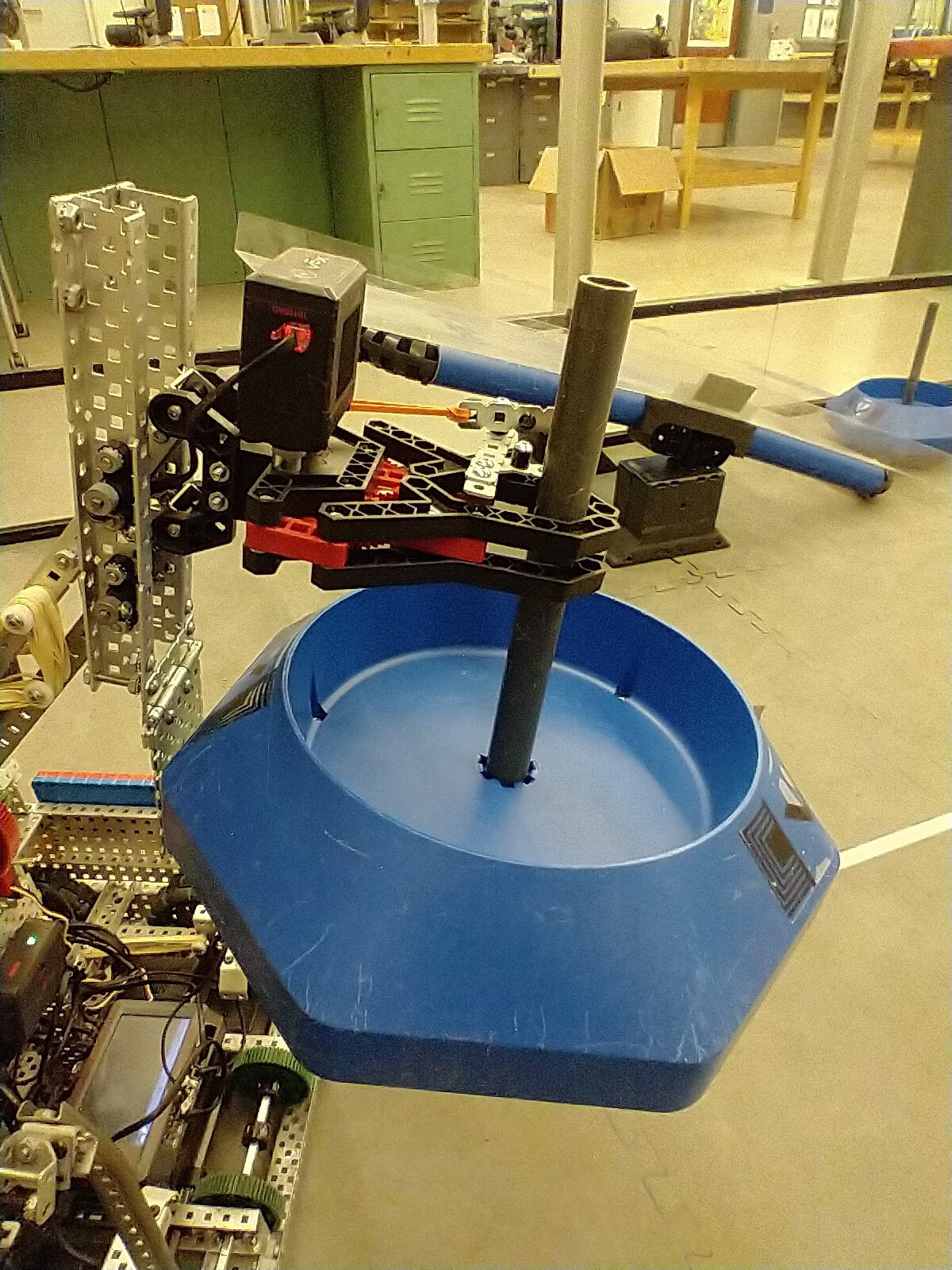

The motor in question powers a standard claw that simply wraps around a mogo pipe so there shouldn’t be any forces acting against the motor. image

The pipe diameter is smaller than the gap between the two sides of the claw so they never squeeze the pipe together (we have another, separately powered bracket, that picks up the mogo from the bottom), so the claw is there to mostly keep the mogo up-right… that’s why I thought it wasn’t doing any heavy lifting. To close the claw programmatically, we turn the motor until it’s velocity drops below a certain value, and then stop. We think we have to set the motor to hold so that the pipe doesn’t eventually fall out, and also to prevent the opposing robot from yanking it out. I guess we could set it to coast when the claw is open, and reset back to hold when we want to grab a mogo. Do you think that would make a difference? And you’re right, we have the torque set to 100%. Is that an overkill for this particular application?
If all you are doing with your claw is supporting the MOGO, you probably don’t need hold anywhere. also, just power the claw until it is closed, and then turn it off. Use code to see which motors are overheating. print that info onto the screen or terminal
If we do that, what would happen if opposition pulled on the pipe? Wouldn’t that force the claw to open?
can you send a picture of your clamp with a mogo in it?
will do tonight. 20chars
Yes. It would open.
I bet you will find, if you check amps, that the clamp is using considerable power.
As the clamp closes it hits a mechanical limit… but the motor continues to turn against the physical limits of the clamp. The only way this is NOT true is if you are counting motor degrees and are stopping at precisely BEFORE the clamp hits it’s physical stop position.
It just takes a few lines of code to display ALL this info to the brain… or controller if you want to. Brain has about 16 lines viewable. Controller has 3.

Thanks a lot for your help, it’s starting to make sense. So if we close the claw the way we do and then turn the motor the other way slightly to remove the tension in the gears and claw components, would the motor draw less current while still holding its position? Alternatively, would setting the motor to coast and then back to hold would have the same effect?
We’ll start keeping a close eye on the motor temps after the state championship this weekend.
Yes. You could close for X amount of time, then reverse X degrees. You will probably find the amps (right now are close to the 2.5 max). After the adjustment, I would expect to find amps at <.25.
The coast/hold method depends on the mechanism having some springiness or rebounding far enough there’s no motor load. It’s also unpredictable.
Here it is:
From the design shown… it should hold well even if the clamp has a tiny gap. You can play with torque values on the clamp motor. Might not need 100%.
start a notebook entry
check amps BEFORE changing anything
dial torque down, 10% at a time
check amps
see if goal falls out during driving/scoring
might not need to have motor reverse… lowering torque might be fine
oh, and swap those star locknuts for nylock nuts.
