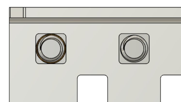

so with a soulder screw do you just put it all the way through the channels and then wrench tighten the nut on?
If its what im thinking it is it cant turn in the hole once its down enough right?
You use it like you would a normal screw
The point of the shoulder screw is that the clearance in the square hole is very tight at the shoulder, therefore making a joint that has minimal slop when the screws are tight. You choose the length of the shoulder (or tenon, as it’s often called an industry) to match the thickness of the material being joined. Sometimes you might need to add a washer under the nut to ensure the nut can be tightened all the way without running out of threads. In some cases, the shoulder screw could be left slightly loose, and combination with a nylock lock nut, to make a basic pivot joint. A joint made this way without a bearing, however, should not be used except for a very light duty or low-cycle mechanism (for example, a mechanism used once per match at the most).
@SaltyCB:
Here is a Fusion image of how the shoulder screw would work.
The one on the left has a shoulder screw, the one on the right is not. The shoulder is in orange for visibility. As you can see, the shoulder screw has no room around the outside, compared to the non-shoulder screw, which has some room.
As you can see here, the shoulder, if the length is chosen correctly, does not extend past the c-channel, allowing you to tighten the nut fully.
