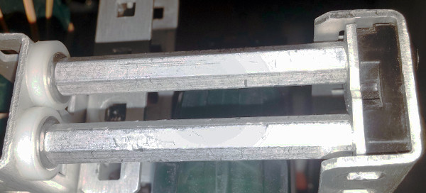

And, if you are using standoffs, instead of nuts, then it is best to insert plastic spacers between the metal and standoff that could compress:
