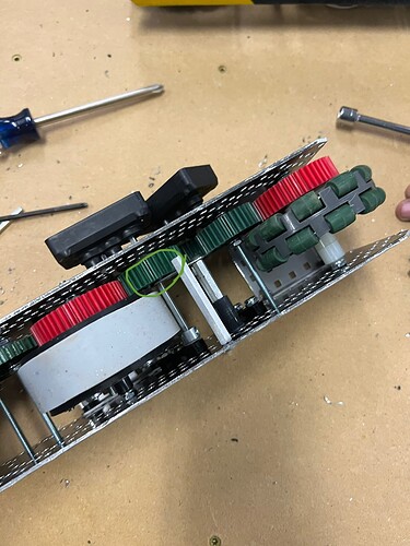

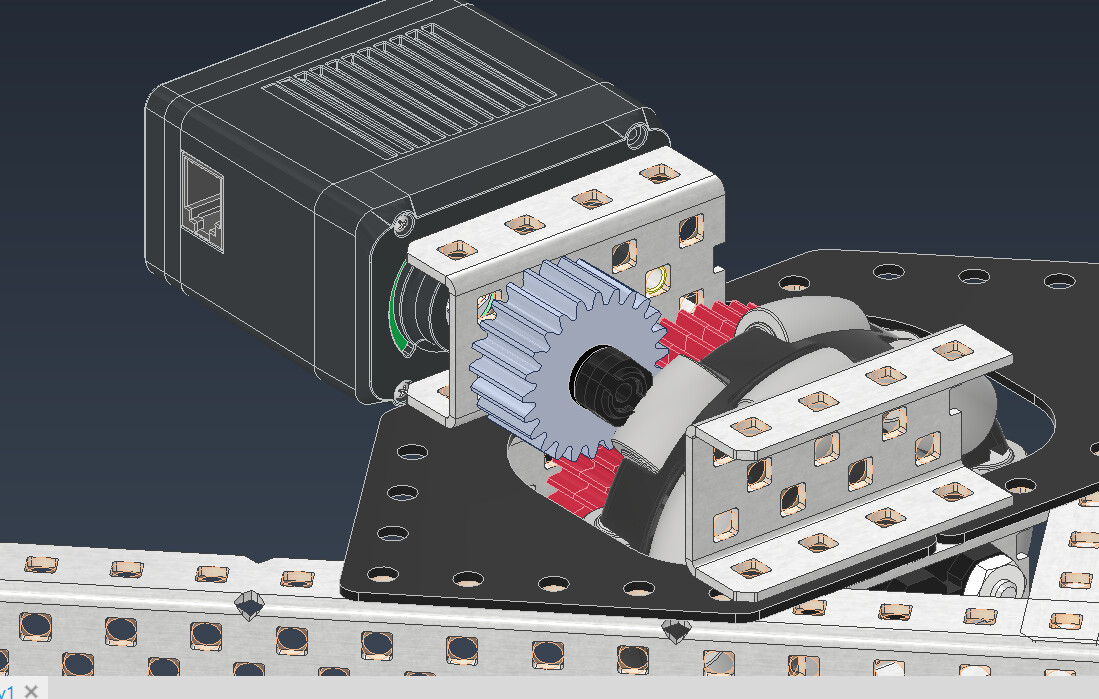

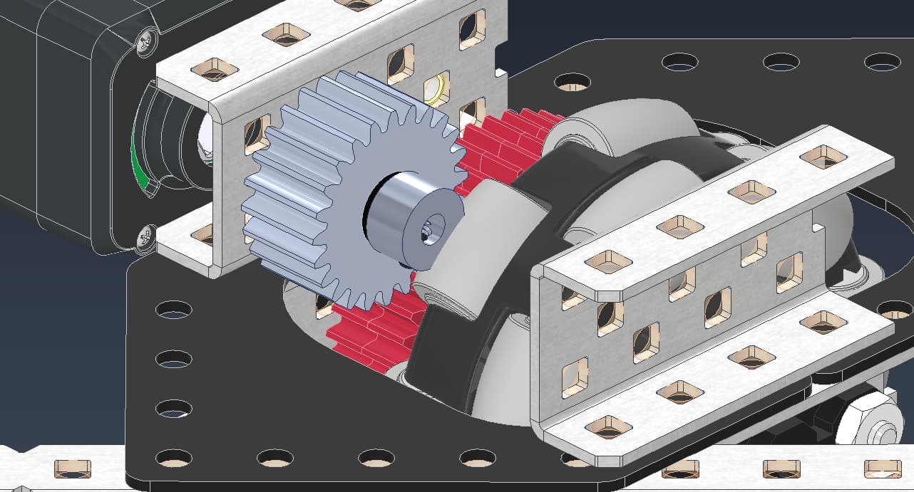

As you can see, the shaft collar in this spot hits the wheel, because 2.75" wheels are weirdly sized. Does anyone know of any lower profile shaft collar alternatives for low strength shafts, other than shaving the shaft collar down (which I’d prefer not to do)?

Oh sorry, I forgot to put in the shaft in the cad lol.
I need the shaft to run all the way across to the other c-channel.

You could bore a hole in the 24t gear deep enough that the shaft collar is recessed but you can still access the set screw. Not sure that is enough to avoid the conflict, probably 1/16 or 3/32 recess.

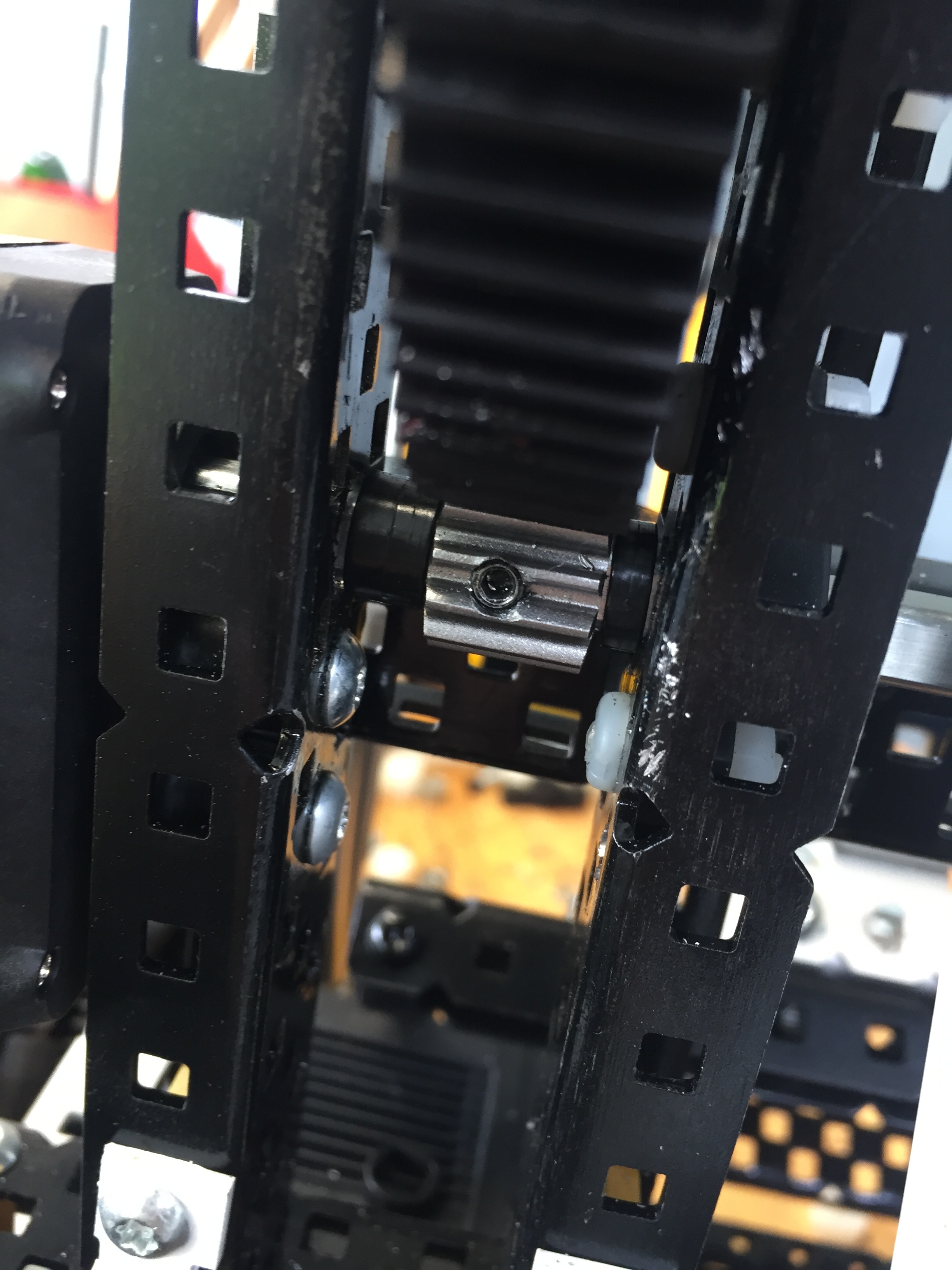

We did this for one of our robots
Would suggest greasing up the contacted area before putting together to reduce friction though.
