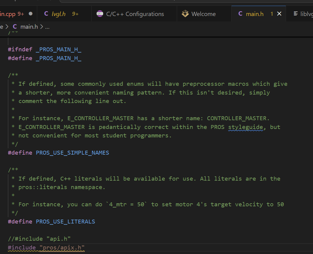

I am using PROS and I was trying to implement LVGL for brain screen.
I followed the instruction here: https://pros.cs.purdue.edu/v5/pros-4/display.html
and changed apix, yet it problem seems to
not fix.
Could anyone provide me with a help?
Thanks
When I include apix in my main.cpp file (as opposed to letting vscode auto-include the headers individually, which I did before) it builds without errors, but that might be because I have probably changed some code in some of my header files to get LVGL to work. I don’t remember what I might have changed though. Quick fix should include the right libraries for you, but you are also using some newer LVGL syntax. PROS 4 uses LVGL 8.3.4, while the newest version is 9.2. Welcome to the documentation of LVGL! — LVGL documentation is the link for the documentation that you should use. For example, lv_screen_active() should be replaced with lv_scr_act().
