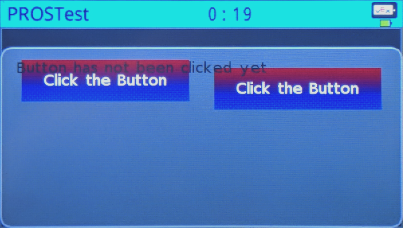

Not full sure what your problem is. I tried your exact code and got this…
LVGL%20Label%20Issue%201
The text appears, through it is over the buttons. To fix that you would just need to change the position.

Thanks, I will replace those variables. It appears that the text is in fact appearing on my screen but in the top section the same color as the background, but it should be where it is on yours. I’ve also previously attempted giving it different styles with different colors so I do not know why this is happening on my screen. Also do you have any Idea why mine is different than yours?
Nevermind, I restarted the PROS Editor and then built and uploaded the code using the buttons in the UI instead of Windows Powershell and it worked. Don’t know which one fixed it or why but…?
