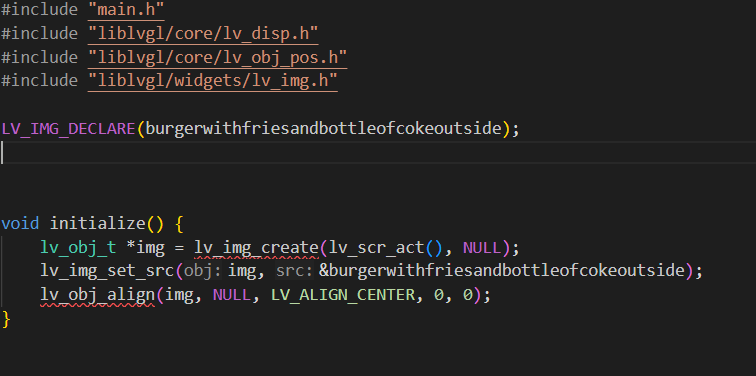

LVGL no matching function to call
is there something i am missing? the tutorial i used was only about a year old.
You are using old LVGL syntax. PROS 4 (which I assume you are using since you include main.h, but I can’t know for sure because you also posted this under VEXcode Pro V5 (which is deprecated)) uses a newer version of LVGL than PROS 3, which is likely what the tutorial you followed was for. In short, to fix your problem just remove the NULL’s.
ohhh, i’ll see if that works. tysm!
