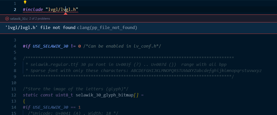

Everything went smoothly until I found this error.
I will really appreciate any tutorial on LVGL on vex brain.
lvgl.h is located at /include/display/lvgl.h.
Additionally, this page has a link to LVGL 5.3 examples.
