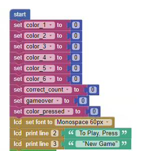

Well, we are back after a LONG week of world’s competition. Many mistakes were made. Very much NOT happy about the radio channel shortage in practice area.
On the m&m bot. Many, many bags of m&m made their way through the bot. I meant to printout the code and have it next to the bot but forgot.

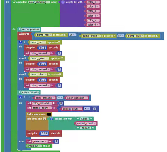

We eventually moved the buttons in front of the screen so users could see the button confirmations.

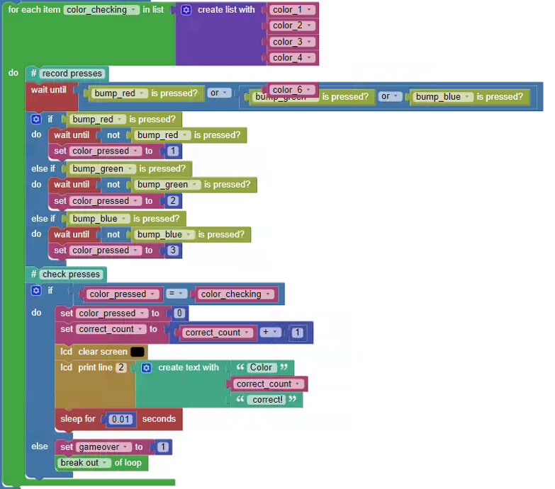

Biggest problem was debouncing the bump switches. We had to ignore continued pressing (slow fingers), but this caused delays between accepting input.
Most of the coding was spent on logic and tightening up the code. Need to come back to button debouncing/input filtering. Probably “if pressed, wait until NOT pressed”.
Here’s a copy/paste screenshot of code. If someone knows how to paste entire thing at once, let me know.
Convert to text (20 char.)
People had problems using the bot due to trying to hit the buttons too quickly, and not being able to remember 6 colors in a row… but that’s another matter.
If you look at the code, we have a delay after the button press. Otherwise the code ‘cycled’ back while the button was being released and ‘saw’ that it was pressed again.
This delay was the problem… edited the code to remove the ‘sleep .75’ line and replaced that with ‘wait until button NOT pressed’. Also, removed the .75 sleep where it displays a correct press.
Result is that it now will handle inputs as fast as you can enter them.

The new ‘button checking’ code. Will take inputs as fast as you can hit them bump sensors.
import vex
import sys
import random
#region config
brain = vex.Brain()
conveyor_ = vex.Motor(vex.Ports.PORT4, vex.GearSetting.RATIO18_1, True)
bump_red = vex.Bumper(brain.three_wire_port.a)
bump_green = vex.Bumper(brain.three_wire_port.b)
bump_blue = vex.Bumper(brain.three_wire_port.c)
bump_newgame = vex.Bumper(brain.three_wire_port.d)
#endregion config
color_6 = None
color_1 = None
color_2 = None
color_3 = None
color_4 = None
color_5 = None
correct_count = None
gameover = None
color_pressed = None
color_checking = None
color_display = None
main thread
color_1 = 0
color_2 = 0
color_3 = 0
color_4 = 0
color_5 = 0
color_6 = 0
correct_count = 0
gameover = 0
color_pressed = 0
brain.screen.set_font(vex.Font.MONO_60)
brain.screen.print_line(2, ’ To Play, Press’)
brain.screen.print_line(3, ’ “New Game”‘)

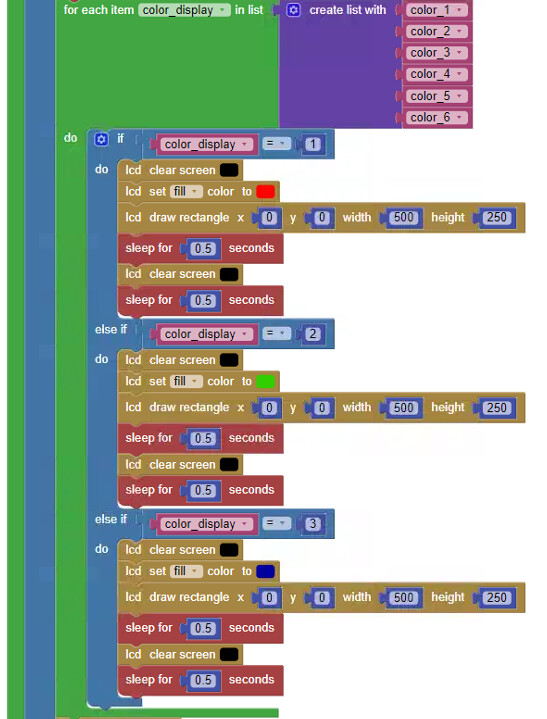

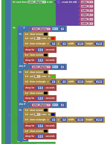

while True:
if bump_newgame.pressing():
# reset variables
color_pressed = 0
correct_count = 0
gameover = 0
# generate colors
color_1 = random.randint(1, 3)
color_2 = random.randint(1, 3)
color_3 = random.randint(1, 3)
color_4 = random.randint(1, 3)
brain.screen.clear_screen(0x000000)
brain.screen.print_line(2, ’ Ready!’)
sys.sleep(1)
for color_display in [color_1, color_2, color_3, color_4]:
if color_display == 1:
brain.screen.set_fill_color(0xFF0000)
brain.screen.draw_rectangle(0, 0, 500, 250)
sys.sleep(0.5)
sys.sleep(0.5)
elif color_display == 2:
brain.screen.set_fill_color(0x33CC00)
sys.sleep(0.5)
sys.sleep(0.5)
elif color_display == 3:
brain.screen.set_fill_color(0x000099)
sys.sleep(0.5)
sys.sleep(0.5)

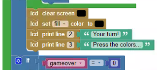

brain.screen.set_fill_color(0x000000)
brain.screen.print_line(2, ‘Your turn!’)
brain.screen.print_line(3, ‘Press the colors…’)
if gameover == 0:
for color_checking in [color_1, color_2, color_3, color_4]:
# record presses
sys.wait_for(lambda: bump_red.pressing() or bump_green.pressing() or bump_blue.pressing())
if bump_red.pressing():
sys.wait_for(lambda: not bump_red.pressing())
color_pressed = 1
elif bump_green.pressing():
sys.wait_for(lambda: not bump_green.pressing())
color_pressed = 2
elif bump_blue.pressing():
sys.wait_for(lambda: not bump_blue.pressing())
color_pressed = 3
# check presses
if color_pressed == color_checking:
color_pressed = 0
correct_count = correct_count + 1
brain.screen.print_line(2, (‘’.join([str(x) for x in ['Color ‘, correct_count, ’ correct!’]])))
sys.sleep(0.01)
else:
gameover = 1
break

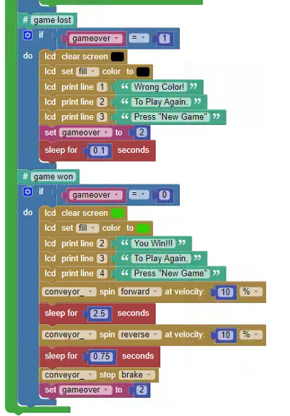

game lost
if gameover == 1:
brain.screen.print_line(1, ‘Wrong Color!’)
brain.screen.print_line(2, ‘To Play Again,’)
brain.screen.print_line(3, ‘Press “New Game”’)
gameover = 2
sys.sleep(0.1)
game won
if gameover == 0:
brain.screen.clear_screen(0x33CC00)
brain.screen.print_line(2, ‘You Win!!!’)
brain.screen.print_line(3, ‘To Play Again,’)
brain.screen.print_line(4, ‘Press “New Game”’)
conveyor_.spin(vex.DirectionType.FWD, 10, vex.VelocityUnits.PCT)
sys.sleep(2.5)
conveyor_.spin(vex.DirectionType.REV, 10, vex.VelocityUnits.PCT)
sys.sleep(0.75)
conveyor_.stop(vex.BrakeType.BRAKE)
gameover = 2
