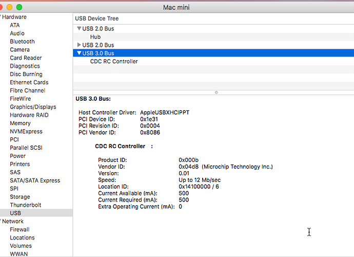

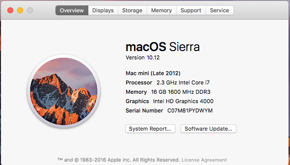

@jpearman I tried on Mac Mini with OS Sierra 10.12. I have attached a snapshot of the System and Hardware Overview.
As you mentioned, the USB connection does show up the VEX board Product ID , Vendor ID and other details. However, executing the command ‘ls /dev/cu.usb*.’ in a terminal does not show the port for the VEX hardware.
Let me know if you need any other info to debug this.

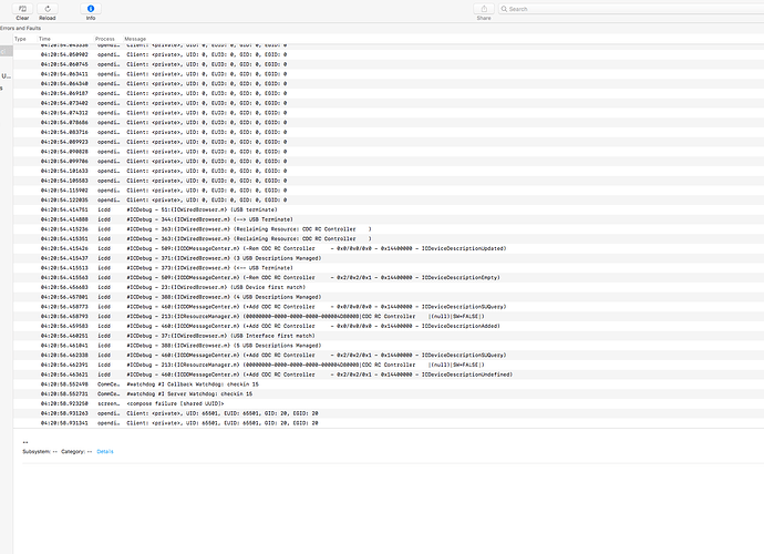

Open up the console (not terminal) and see if it gives the following when you plugin the cortex.
12/29/16 2:01:32.000 PM kernel[0]: VexCortexCDC : We have vendor 1240 and product 11
12/29/16 2:01:32.000 PM kernel[0]: VexCortexCDC :Probe, score is 100000
12/29/16 2:01:32.000 PM kernel[0]: ----------------------------------------------------
12/29/16 2:01:32.000 PM kernel[0]: VEX Cortex CDC/ACM Driver
12/29/16 2:01:32.000 PM kernel[0]: Version 1.0.0 - James Pearman 2013
12/29/16 2:01:32.000 PM kernel[0]: VexCortexCDC : Device Name   = CDC RC Controller
12/29/16 2:01:32.000 PM kernel[0]: VexCortexCDC : Version number - 1.0.0, Input buffers 8, Output buffers 16

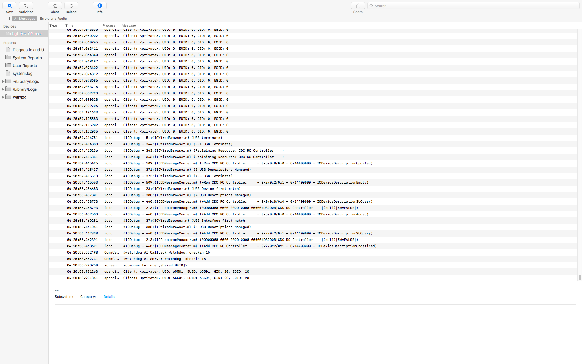

I have been trying a few debugging steps over the past few days but no luck on Mac Sierra with detecting VEX COM port.
I tested the hardware on Mac 10.12, 10.12.1 and 10.12.2. I tried reinstalling the driver. I used the ioreg command and tried to look at the I/O kit Registry to find something that may be causing the issue but nothing helped. I have attached a screenshot of how the console looks when I plugin the cortex. Not sure what’s going wrong. Can you please suggest what may be missing?

I did have a look into this, it’s all related to the rewrite of the USB stack that Apple released as part of OSX 10.11. Looking at your ioreg logs, I see that under 10.11 the cortex is seen as a “AppleUSBDevice” where under 10.12 (on your Mac) it’s a “IOUSBHostDevice”. When I look on my old laptop running 10.12 I see it as a “AppleUSBDevice”, why I don’t know, perhaps it’s hardware (USB 3 vs USB 2) related. Apple pretty much changed everything for USB drivers in 10.11 although kept some backwards compatibility support, lots of people have had issues. So at this stage I don’t hold much hope for this driver moving forwards, fundamentally the USB implementation in the cortex was broken and this was a bit of a hack to make it compatible, I don’t have the bandwidth (or suitable hardware that exhibits the issue) to look into this anytime soon. I rarely use the driver myself, 99% of my programming is done using the programming kit via the joystick so I don’t really have much motivation to support it.
