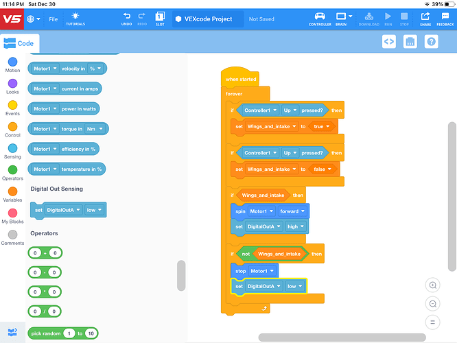

How would I go about setting macros in VEX Blockly? (At least I’m pretty sure that’s what it’s called, its the one with snap together code)
I am looking to press 1 button to spin my motor driven wings out and 1 button to bring them back in.
Make a Boolean in the orange section. Make when button 1 pressed set Boolean to true and when button two pressed Boolean false. Make it so that when Boolean is true wings go out and motor spins and when false wings go in and motor stops
Could you clarify a little more? This is where I am at currently
Use an “if else”, with else being the close
If (boolean) then:
(Wing open)
Else:
(Wing close)

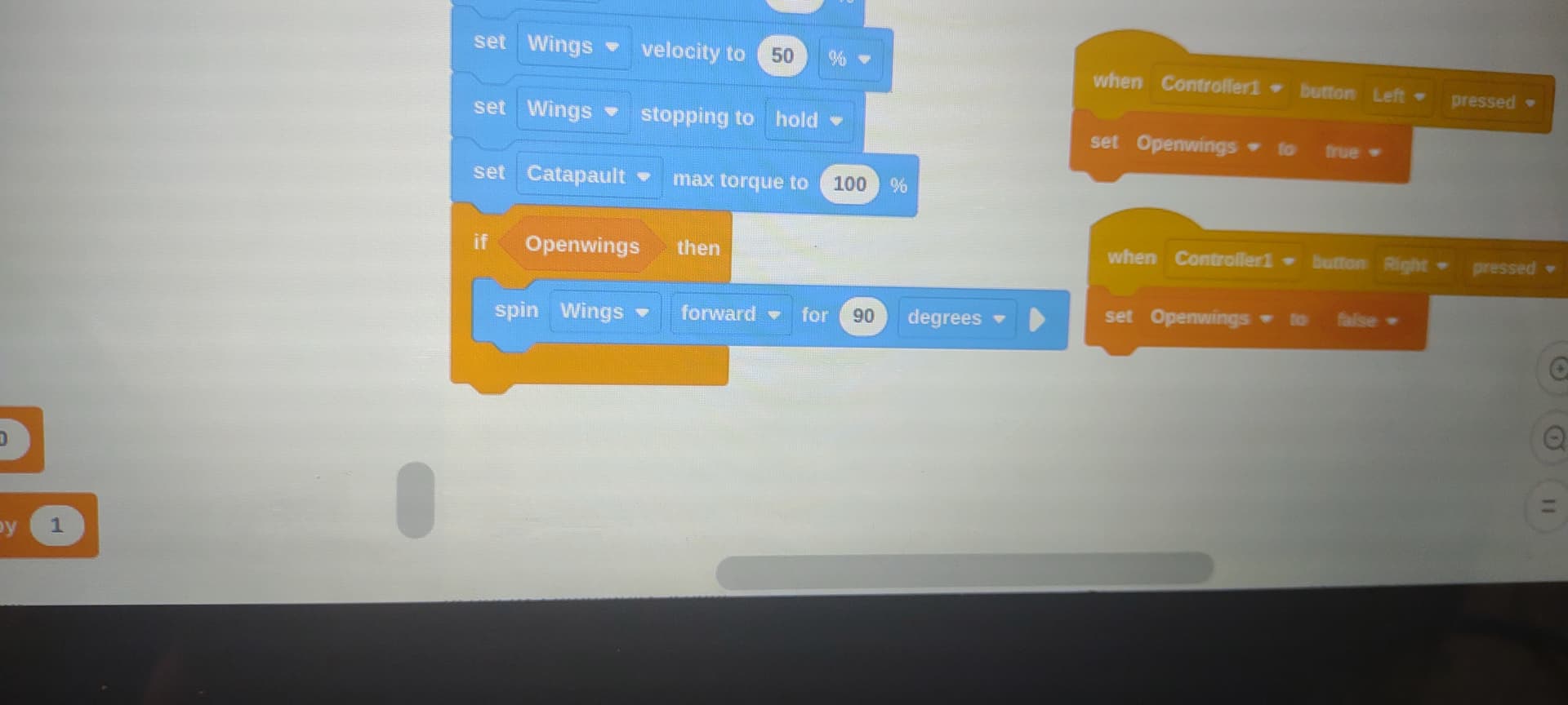

Would I be able to do this with variables? We also want to be able to spin the wings to be facing in front of the robot (which means spinning it forward 180 degrees) while also having a button for it to go forward 90 degrees. Or is there a way with Boolean?
@Nathan_technado used a boolen
For your 3 setting (0, 90, and 180 degrees), you can have something like this pseudocode:
if (controller button pressed) then [
__if (variable <180) [
____variable ++ 90 = variable
____motor spinToPosistion (variable, degrees)
__]
//when variable is 180
__else [
___variable = 0
___motor spinToPosition (variable, degrees)
__]
