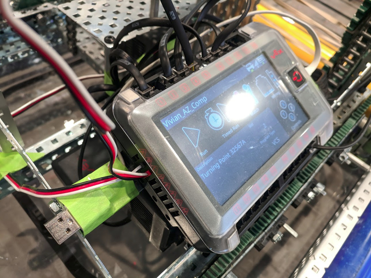

Instead of magnetic cables, you can save some money (and possible frustration—I see that a lot of magnetic cables on Amazon get bad reviews) by using a short micro-USB cable and attaching the USB type-A male end somewhere on your robot:
I just connect using a USB extension cable.
Though, it does seem like a good idea to get a magnetic cable for the controllers since the pictured solution would probably be too unwieldy to use on a controller.

Better yet, get something like this:
That way, in addition to saving the port on the Brain, you can make it significantly more convenient to connect to it for programming.
Theoretically, this would not be legal to leave on a V5 brain for competition, as R<7>h as written applies only to the cortex and vexnet keys. Even leaving the little magnetic connector in the brain wouldn’t be legal either. But as an inspector at local and state events, I’ve never disallowed this. Possibly World’s inspection might be different.

Actually, this was ruled legal. Here’s the Q&A: Legal non-functioning decoration? V5 USB extention left mounted during matches : Robot Events
Good to know. Hopefully the game manual is updated next year.
I don’t think they need to update the manual, the small magnetic connector is effectively a really short USB extension cable.
A USB extension could also be argued as a nonfunctional decoration since it serves no functional purpose during competition, so double legal?
