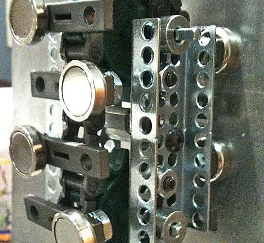

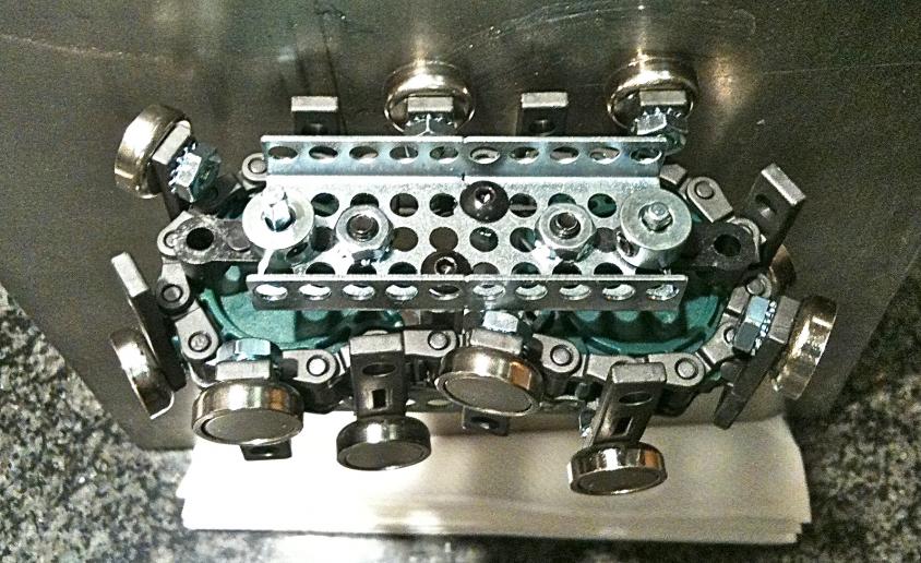

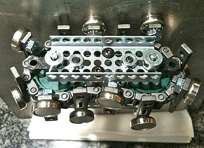

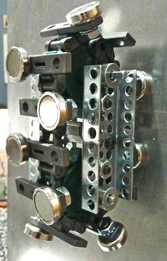

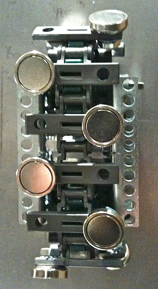

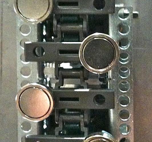

I decided to prototype one as an experiment. I used 12 of the cup magnets I linked above attached on a stagger pattern to a 24 segment high-strength chain.
The magnets I used are rated for around 20 lbs of pull force, but since they are lifted off the surface by a tipping action, the tracks don’t have to apply 20 lbs of force to retract the trailing magnet.
It does take more force than I think would be desirable, but it can be done. I was able to make the contraption advance up the wall by applying a rotating force to one of the axles by hand (using a gear as a handle). Nothing broke or twisted, though it was a very jerky ride. Since we’ve seen that Vex can be geared so low that it can twist an axle, I’m convinced it could be made to be driven from a vex motor.
The trick here is that the track only ever lifts one magnet at any time, but many (4 or 5 in my case) are in contact with the metal wall. I think it would be better with twice as many magnets that were each only half as powerful - that would provide the same draw to the wall but with only half the force needed to advance each track. Perhaps adding felt pads to the faces of my magnets would have the same effect.
Oh, and with 4 or 5 of these magnets holding the track on the steel, it could easily have supported a battery, motor, gearing, microcontroller, etc. The only way I was able to get this off the steel was to walk it to the edge - I couldn’t pull it straight off.
The other thing to keep in mind is steering. A pair of these tracks would have 8 to 10 magnets in contact with the surface, and I just don’t see skid steering working very well. It might work but with a large turning radius (no rotating on the spot or stopping one track to make a tight U turn).
Here are a few pictures of what I threw together:
[ATTACH]2381[/ATTACH][ATTACH]2386[/ATTACH][ATTACH]2391[/ATTACH]

Nicley built, Quazar. The only problem I see now with that is that the magnets are now moving, possibly creating electrical current in the wiring. Be careful how you set it up.
Trust me - it isn’t going to be moving fast enough for that to be an issue :wink:

I think that would work very well. One reason the ride was rough was the staggered pattern - the track would lean one way and then the other as it struggled to pull off each magnet. Having it balanced would probably work better and put less stress on the plastic links.
I don’t think that would add much pull. The magnetic strength falls off very quickly with distance, so the rear magnet wouldn’t contribute as much to the holding force. The small magnets have a bigger brother that might be a good option instead of stacking (twice the pull force, and a #8 diameter mounting hole).
I thought about that, and yes you can make a chain that is tight around a sprocket. I think you need to keep a few magnets in contact at all times. The magnets really only hold strongly if they are completely in contact with the surface - as soon as you tip them a bit, their holding power falls off considerably (the track solution I made counts on that). A tight track or wheel with magnets wouldn’t provide enough pull to hold the robot in place while you were “in between” magnets.
Yep. The magnets I used were so strong that I had trouble sliding it around my hand - I think a pair of these tracks could easily hold a full vex robot up without sliding. A thin silicone rubber pad would reduce the pull force and increase the friction, which might be a better option than going with more, weaker magnets.
It also occurred to me to replace the rollers on an omni wheel with small tube magnets (I didn’t find any exactly the right size). I think this would have overcome the steering problem, but I don’t think it would provide enough holding force because only 1 magnet from each wheel would be contributing to the holding force, and only the magnets aligned perpendicular to gravity would be resisting sliding.
Agreed, though I think such designs are more sensitive to wall uniformity, but would certainly be a smoother ride and probably simpler to build. I’ve seen wind-up fridge toys that use this approach. If I find some time, I’ll try to mod my design to use this approach and see how it goes. The trick there is going to be to keep the magnet a very precise distance off the wall surface. Too far away and it’ll fall off; too close and it’ll grab. The sweet spot is a very narrow range.
