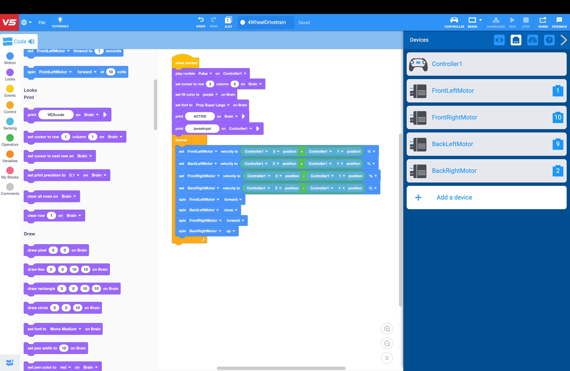

You are able to classify the motors individually so that they can be programmed to still act as though they are paired. Here is an example of a 4-motor drivetrain paired individually:
Just do this with two more motors.

Thank you Payne. we can do that. I kind of thinking if VEXCode can support adding 6-Motor drivetrain in Devices, we can take advantage on internal PID and calibrating Inertial sensor.
That way the auto code can be easier and more accurate.

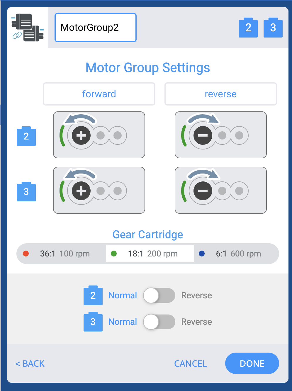

One thing we could explore is adding a 3rd motor to the “motor group” device, then you could have your left / right side drive configurations handled there as at least one logical “motor group”. This gives you the flexibility of reversing individual motors as needed within the group.
