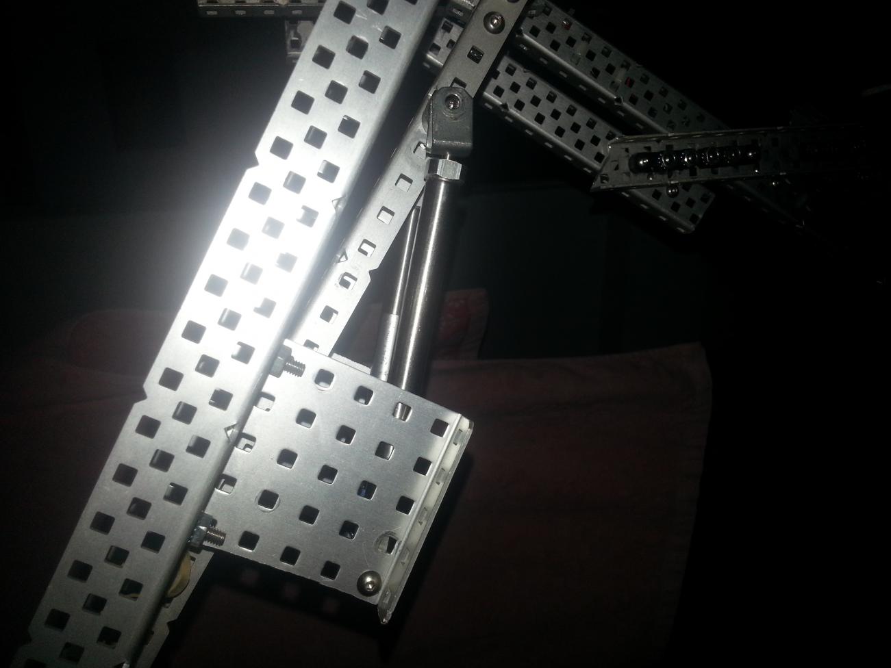

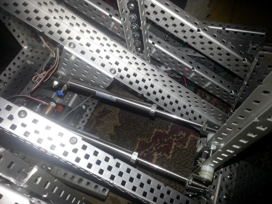

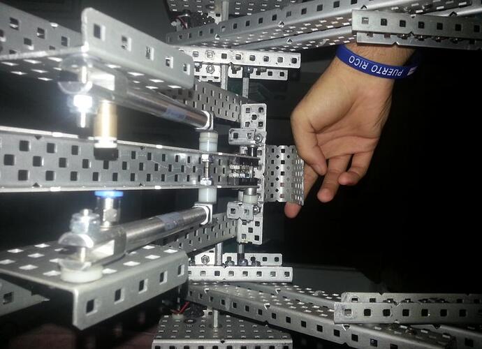

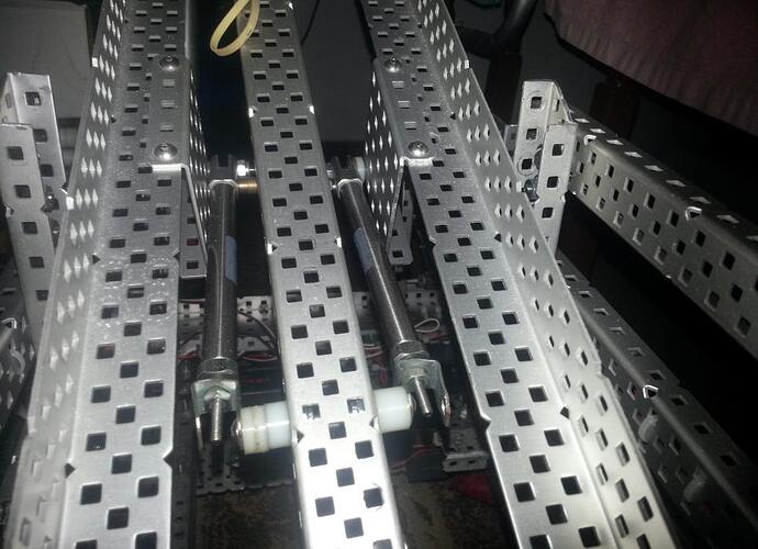

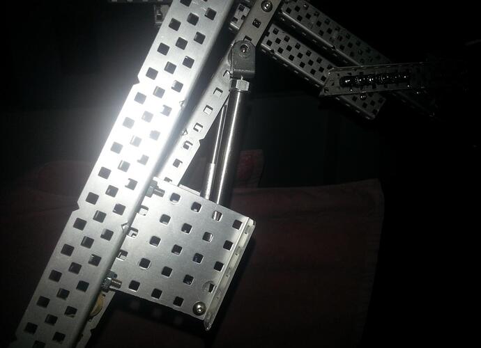

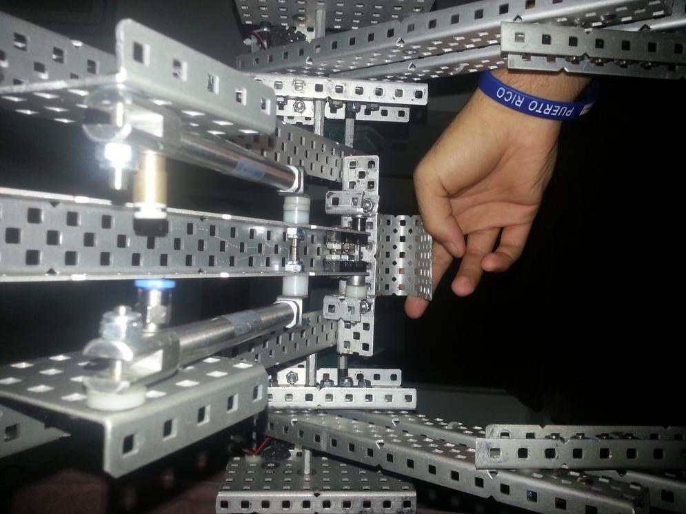

I have made a forward firing catapult for the robot that my team and I have made. It is powered by two pneumatic es and it does actuate pretty good it just is not powerful enough. I think it needs more acceleration but I am not quite sure how to do that. if any one can give me any suggestions that will make it stronger will be greatly appreciated.

One problem with your catapult could be the angle of the pistons. You want the pistons to be as close to 90 degrees to the catapult arm as you can. Also check for friction.

Another design aspect to consider is your use of elastics (like rubber bands). Our catapult works primarily due to the quick pull of the rubber bands, meaning the pistons are mainly used to keep the catapult down when not firing.
I have thought about that. I just did not know if the rubber bands would keep the catapult form going down, I will just have to test to see how man rubber bands will allow more acceleration and allow it to still go down.

You should move the angle that the pistons push at closer to 90 degrees as your current setup only has that angle when fully extended, which is good, but it can’t overcome the primary force due to the angle when the catapult is in resting position.

The big issue I see that you are having is what Andriod (Ruiqi) was saying above.
You want the piston to act perpendicular to the lever to use your power most efficiently. What you have now is actually pushing most of its power into the joint rather than into launching the object. Right now you have something like a 15 degree angle when a 90 degree is optimal.
How to fix this would be to lower the location that the piston is mounted at.

-Better angle of firing. Having the pistons that close to parallel to the catapult arm is wasting energy.

You also don’t want your catapult to go that far forward. Mount your pistons lower and further back on the catapult arm to reduce the angle change.
