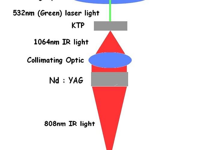

Then was looking at how lazer pointers worked and what lenses they used to get a focused beam.
[ATTACH]9344[/ATTACH]
Maybe i could use the the one that is shaped like an oval to focus it by bending two pieces of plexiglass and facing them toward each other and sending the light throught that.
