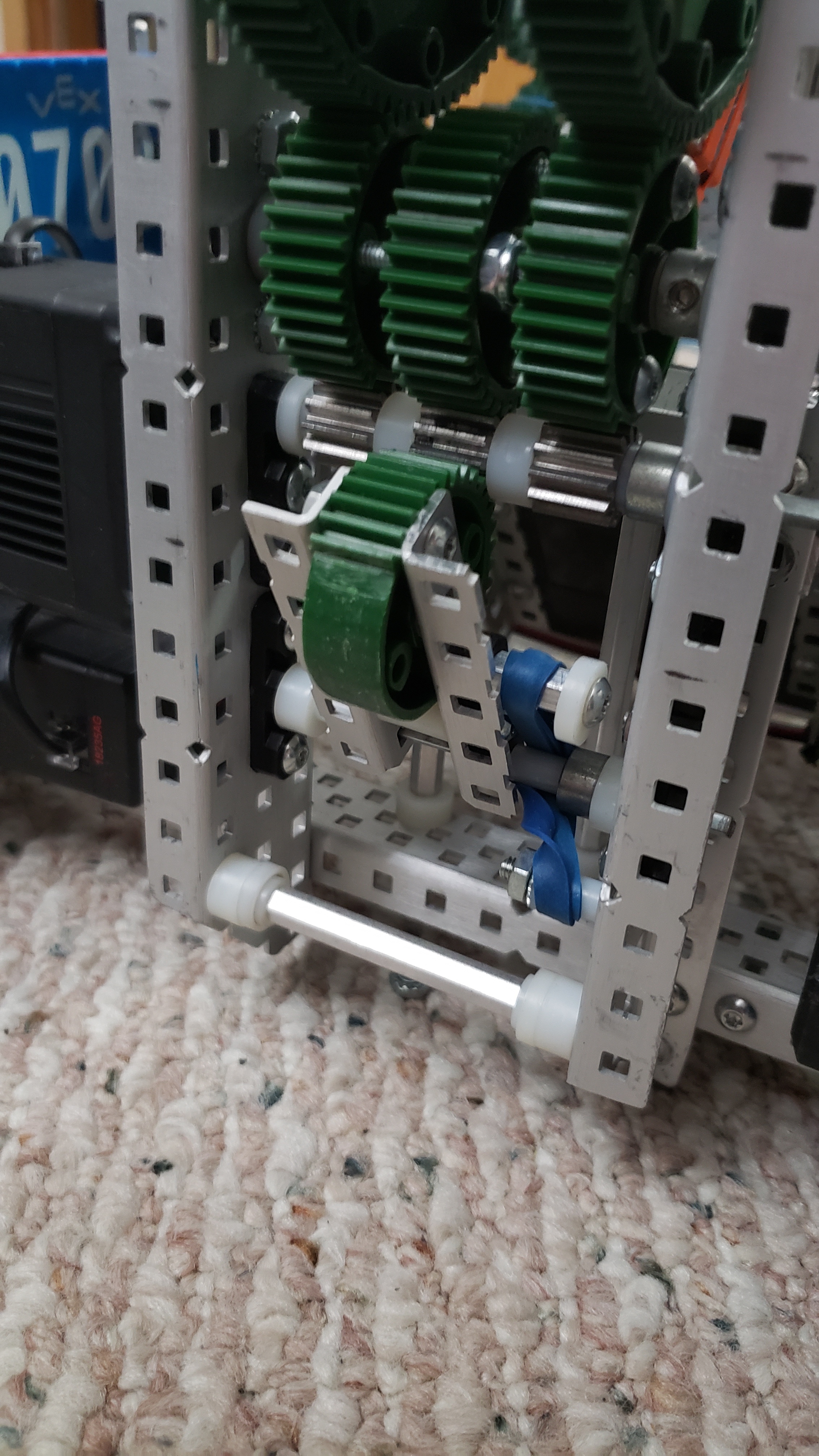

Our current ratchet and pawl mechanism is experiencing some precision issues, and so I was wondering what methods there are for making a ratchet and pawl more precise without increasing the size of the ratchet gear itself.

Here are some pictures
you could add more tension to the ratchet or try moving it to a larger gear.
White spacers next to pinions can sometimes cause issues (Because I’m pretty sure the outer diameter of them is bigger than the lowest point in the pinion’s teeth). Not sure that is the issue, but may not hurt to try and replace them with something smaller like the black spacers.

if you switch to a vex official ratchet, the faster it spins, the more often the pawl will set to the next tooth, therefore making it more precise.

We pretty much just did this & put a rubber band on it to keep engaged at all times; works fine to hold a heavy-shooting puncher back.
