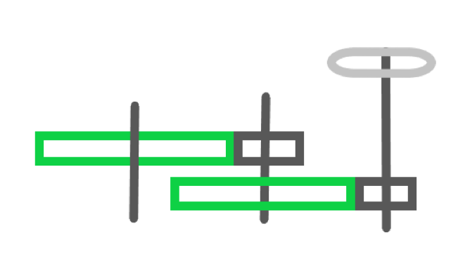

Can you show an example of this? I think I have the right idea but I just want to make sure.
Green is 84 tooth gear, dark grey is 12 tooth gear, light grey is flex wheel Screenshot 2022-05-12 135709

he could do the same on the others side and use a compound ratio on both sides
This might not be able to start because of the lack of torque. Also with the compression it might not be able to move.

Screw-in your bearings first off, this won’t help with power but will be better for many people’s sanity. And a compound ratio, like show by many people above
I was just suggesting things that he could do to make his flywheel more powerful, not all at once, the compound gear ratio is just an example because he wanted to see one.
