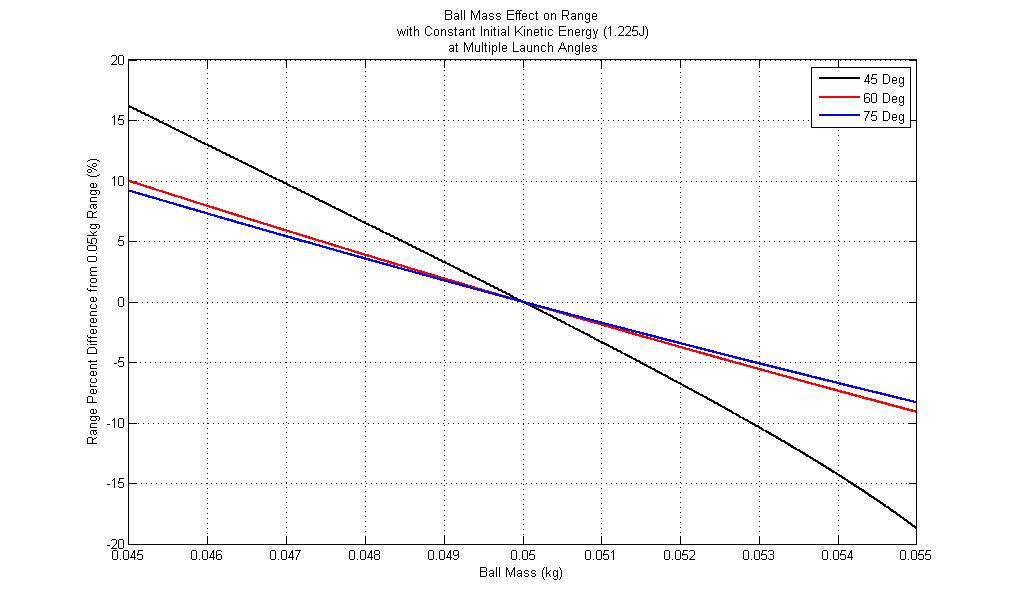

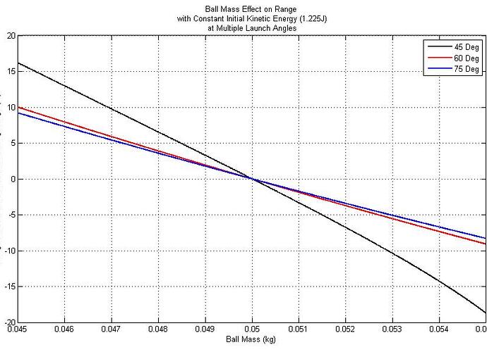

Here is a plot I made in MATLAB real quick. I think it backs the basis of your theoretical musings (the 10% range difference you mentioned). The ball is launched from an initial height of 0m to a final height of 1.03378m. The points were calculated with a constant kinetic energy of 1.225J (7m/s shot with a 0.05kg ball). Model includes smooth sphere drag that takes into account a variable coefficient of drag. Sea level conditions were used for gravity and air properties. Balls have no spin.
https://vexforum.com/attachment.php?attachmentid=9384&stc=1&d=1432860585
There are a few interesting things I saw. Firstly, the lines are roughly linear. However, you can see that the percent difference is not the same when the ball is 10% more massive compared to 10% less massive. Also, you can sort of see how the 45 degree line curves on the right side. The launch angle clearly has an affect as well.

You are reading the plot right. And yes, it is wrong to assume that the balls will be launched with the same kinetic energy as their masses change. This plot is simply here to validate vamfun’s initial calculation that gave him 10% variation. He had used a model without drag to come up with this value that related the change in mass to the change in range with a constant kinetic energy, so I wanted to verify it with a model that included drag.
If we assume a no-slip condition, then the balls will not be launched with the same kinetic energy or velocity because as energy is transfered to the ball the flywheel(s) will slow down, and the amount of energy tranfered is dependent on the ball mass. Vamfun went on to calculate how much kinetic energy is transfered to the ball assuming no slip. I was going verify this and make some plots later on when I have some more free time.

The plot can only be for catapult since the kinetic energy is constant which is what you intended to check on. The slope variations are a little misleading since even though they are at the same height, the nominal 0 percent error will have a different range for each launch angle. Typically, the kinetic energy needs to be adjusted for different launch angles. i.e. Rmax = v^2/gsin(2theta). Maybe run again but adjust the kinetic energy to keep the range the same for all thetas.

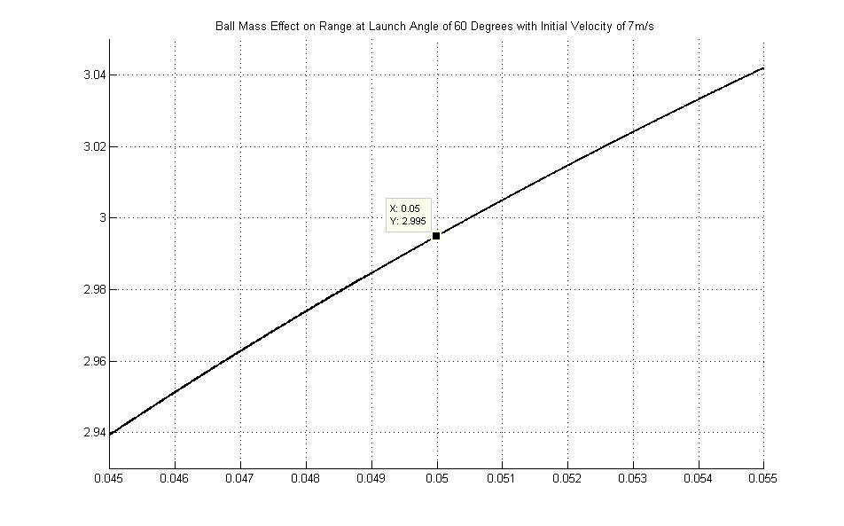

I would like to get some feeling for how just the air drag affects these balls vs. their mass (ballistic coefficient effects). Could you make a plot that assumes each ball gets launched at the same speed and angle (~45 to 70 degrees) with zero spin and the ball masses varying by +/- 10% of 0.050 Kg? :slight_smile:
Sure thing, I’ll be home and get yours and Vanfum’s plot posted in probably 2 or 3 hours. Is there any particular speed you are interested in? If I remember right, a 7m/s shot at 45 or 60 degrees (I can’t remember which) gives a range a bit longer than the diagonal of the field.
Not really. I’m just curious about the relative effect.
That sounds good. Give that a try, if you don’t mind. Thanks! :slight_smile:

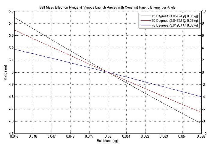

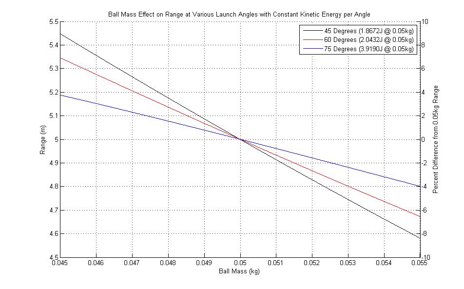

Sorry it’s a bit later than I said. Here is the plot for Vamfun. I arbitrarily chose 5m for the range.
https://vexforum.com/attachment.php?attachmentid=9385&stc=1&d=1432959040
Looking at it now, I can’t tell which line is which based on the plot (I’m color-blind). For those having difficulties, looking at the left side of the graph the top line is for 45 deg, the middle 60 deg, and bottom for 75 deg I think :frowning:

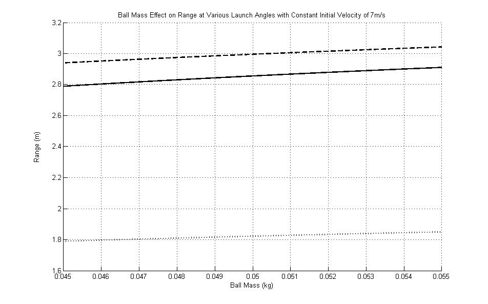

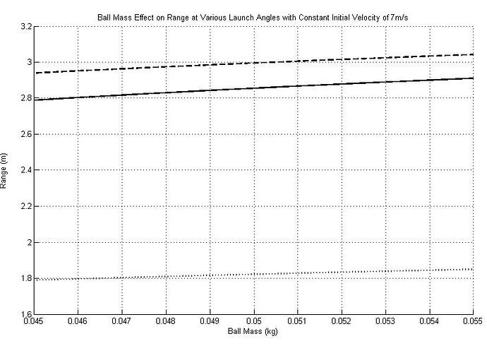

Here is your plot FullMetalMentor. The first one includes all three launch angles. I used a different line style this time. Which is easier to read? I can make the color plots lines thicker if that helps.
I forgot to include a legend. The top dashed line is 60 degrees, the middle solid line is 45 degrees and the bottom dotted line is 75 degrees. I am really sorry I forgot that. I can fix it if anyone needs it.
https://vexforum.com/attachment.php?attachmentid=9386&stc=1&d=1432960351
I also made a plot of just the 60 degree launch so you could see the curve a bit better.
https://vexforum.com/attachment.php?attachmentid=9388&stc=1&d=1432960423
It is interesting to see that the relationship is not quite linear, however a linear approximation would probably work fine in this case if you were able to measure the mass of the ball. It may be more interesting to see what it looks like when we include spin. I can try that if anyone is interested.
This is excellent! So it looks like if speed can be accurately controlled, then the ballistic coefficient differences won’t necessarily be a dominating factor. :slight_smile:

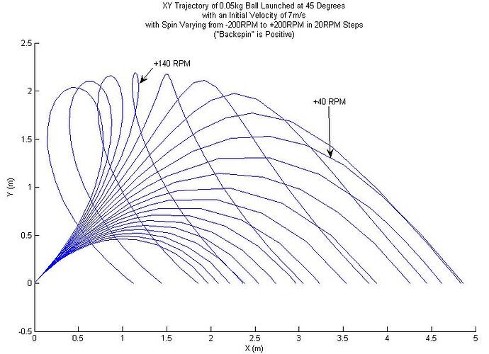

Remember that the plot uses a constant initial velocity of the ball right after launch. Vamfun has shown logically that if you were to keep the flywheels at a constant speed and vary the ball mass, they would have different exit velocities. I’ll try to incorporate this aspect into the model and give a plot soon. So far Vamfun’s calcuations have looked solid so I don’t think I’ll find anything interesting :slight_smile:
So I think I have the theory down well. However, considering the assumptions I had to make, I wouldn’t be surprised if empirical data doesn’t match up nicely with theoretical data. Don’t get me wrong, I think the model is better than not accounting for spin. But until I get my hands on some real-world data I will hold my tongue on the validity of my work.

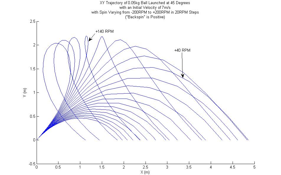

EDIT: So I made a serious mistake. Every time it says rpm in the following bit should instead be rotations per second. Sorry! And thanks to Vamfun for pointing it out.
Here is a plot I made that incorporates spin. The left-most loop has +200RPM (backspin) and the shortest shot has -200RPM (topspin).
https://vexforum.com/attachment.php?attachmentid=9392&stc=1&d=1433017844
I noted the interesting points where you see the ball starts to loop back around 130ish RPM and how we see our range maximized around 50ish RPM. One thing to note is that I assumed the ball had a constant rate of rotation through the entire flight.
