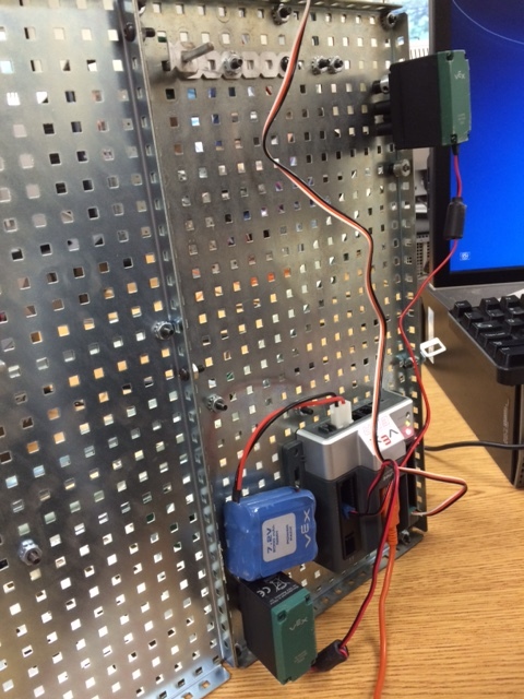

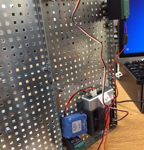

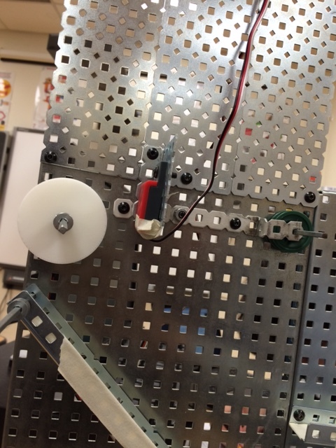

We are sophomores and we are working on our marble sorter project. Our group has very little knowledge on robotc and programming in general and we would like some help. Our sorter has 2 servo 393 motors, a light sensor, a custom 3d printed object, string etc. We are trying to make the light sensor detect the type of marble(glass, wood, and metal) so they can be sorted. We would like the lever to go down to that certain metal piece(3 bars) to make the marble roll down into a certain cup(haven’t really decided)How do we achieve this? Thanks again.
Here are some pictures:
The big challenges of the marble sorter are:
  1. Detecting the kind of marble. You can do this independently by the light sensor and seeing what the values are for each kind of marble. Do you have other sensors too like the line follower to use as a second type? (You may want your sensor closer tot he marble so background light is not interfering) Get a good handle on what ranges each marble type gives you. Then turn your apparatus so the background light changes and see if it still holds true. Use the debugger for this to see the values real time.
  2. Processing one marble at a time. Making sure you only do one marble at a time is key as you don’t want the same decision applied to many marbles of different types. I’ve seen the black intake rollers used with success here. Not sure what is on your white disk to do one marble only.
http://www.vexrobotics.com/media/catalog/product/cache/11/image/296x/5e06319eda06f020e43594a9c230972d/i/n/intake-roller_1.jpg
  1. Sending them the right way once you know what marble it is. Looks like you have the structure. But you need some measurement device to know which section the feeder is pointing to. Make sure you give enough time for the motor to move the arm before releasing the marble too. Is your rubric more on speed or accuracy?
Use a potentiometer or an IME for determining arm position. The pot has many more advantages over the IME.

Thank you very much for the response. We will try out the potentiometers. The white disc has small hole in which the marble will be dropped into and it will rotate. The hard part for us is the actual coding
The potentiometer only goes 270 degrees so don’t rotate it all the way around or it will break. Put it on the back side of the arm joint but you need some space to attach it. Some metal or 1/2" standoffs to stabilize the pot to the axle and the base. The shaft moves, the pot stays grounded to the frame. Otherwise it does not change values.
To program the potentiometer, look for ranges of acceptable values to be in for the arm position, then drop the marble on to the track once you know the arm is in the right place. Knowing which way to send the arm is an error calculation of “how far am I away from where I want to be” of
SensorValue[my_potentiometer] - target_location_value
Then apply power based upon the distance away (and multiply by a limiting factor like 0.10 to slow the motor down a ton, you have about 7.6 pot values per degree of movement)
