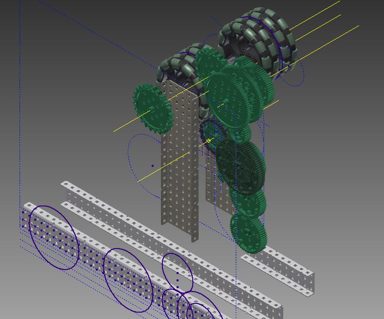

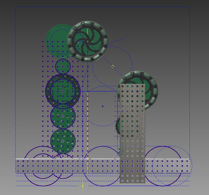

The base transmission. I think… I may have posted it a while ago?
https://vexforum.com/attachment.php?attachmentid=9478&stc=1&d=1435798332
https://vexforum.com/attachment.php?attachmentid=9479&stc=1&d=1435798332
https://vexforum.com/attachment.php?attachmentid=9480&stc=1&d=1435798332
Powering motors of the base are directly attached to the gear that’s sketched out but not put in.

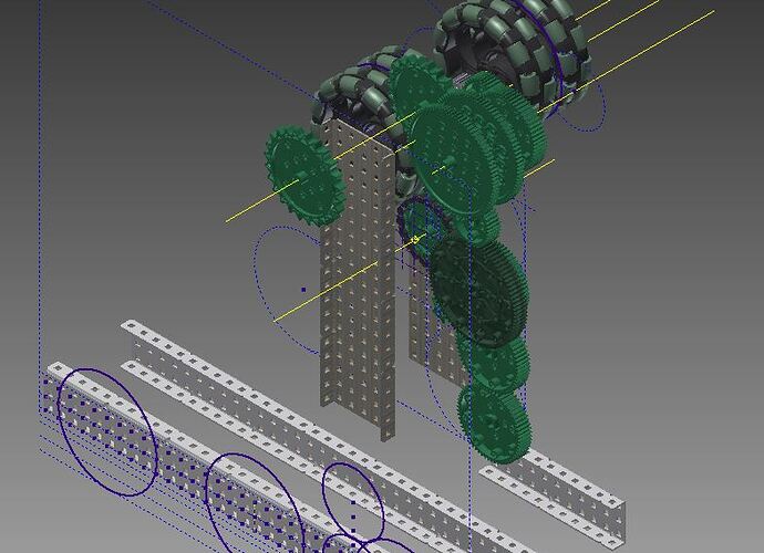

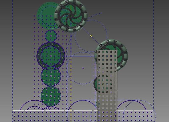

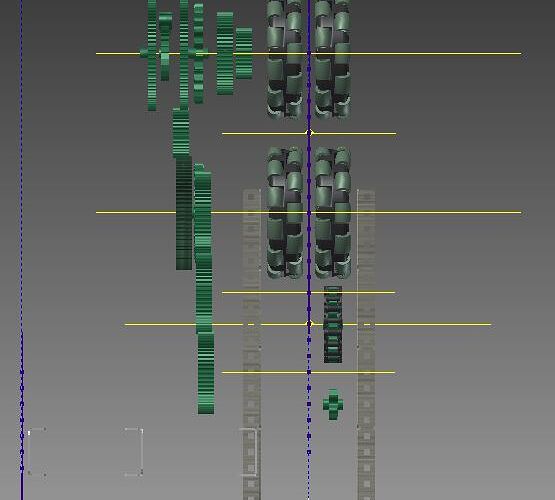

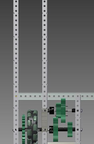

The launcher/transmission design:
https://vexforum.com/attachment.php?attachmentid=9481&stc=1&d=1435799486
https://vexforum.com/attachment.php?attachmentid=9482&stc=1&d=1435799486
https://vexforum.com/attachment.php?attachmentid=9483&stc=1&d=1435799486
The big 84 tooth gear on the top is the ratchet. The 84 tooth high strength in the middle is where the flywheel/base motors will go. The 36 tooth and 60 tooth directly above and below it are the shifting gears – when one hooks up something, either the base or the flywheel, the other idles.
Notice that I have not yet put in a lot of structures, just the gears lined up on the axes in the sketch file. This is the method I found very helpful – making gearing precede structure design, and making them independent from each other.
Structure is the thing I hate the most in VEX, because it always drives me crazy… the c channel’s total thickness is always 0.5 + 0.063 inch, which can drive me into nuts sometimes. I find that making the structure first, then putting gears in the holes a very stupid idea. Because structure design is something you need to spend time to ensure the strength and efficiency. You need to change it a lot as time goes.
Before you know where the gear tower should be, model where the gear should be and then design gear tower accordingly. That’s my tip of designing in inventor.
