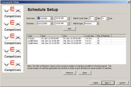

Lance,
At Toronto we ran with 4:00 match spacing with two fields. We had a very experienced crew across the board - scorekeepers, refs, organizers, and A/V. We scored a match AS the next match started. When that match finished, we announced the score of the previous match. Do not underestimate the time needed to announce the prior match scores, setup and announce the teams on the upcoming match, and checking for readiness of the crew and field prior to a match.
We ran with a 3:30 match spacing for practice matches, since we did not have refs do a fully verified scoring procedure.
We had 42 teams in attendance, ran 6 qualification matches per team, 1 practice match per team, and had to re-run 2 qualification matches.
At the end of the day, we finished the event 5 minutes early vs. what was scheduled.
I think 3:00 match spacing is too ambitious. Everything will have to run absolutely perfect, with no scoring disputes, minimal time to announce scores and teams, etc. Even then, the smart money will be that you’ll run late.
Lance,
I captured a screenshot from our Tournament Manager Scheduling configuration in the Wizard.
Doors opened at 8am, and our awards ceremony ended at five minutes before 6pm.
