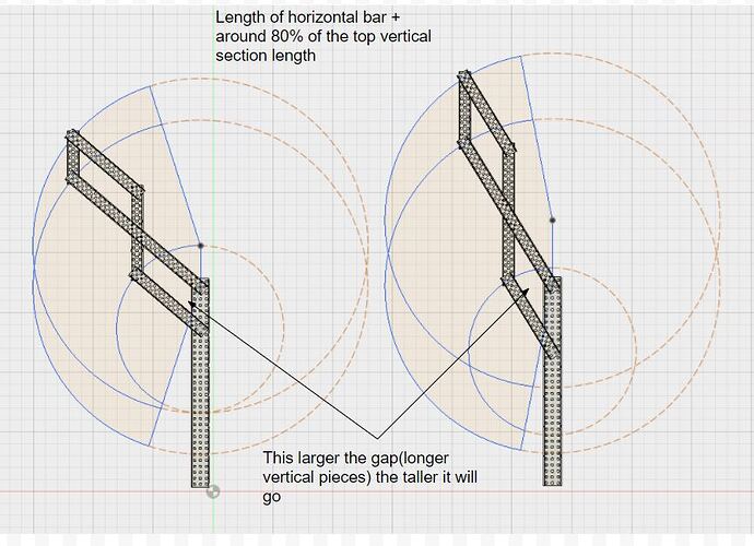

I don’t know a formula but I build models in fusion 360 to experiment with new configurations. Here is a pic that might help with your search. That note is a general guide and not a formula.
A big question is how far apart you can space your bars. If all the bars need to lie in two planes (verticals in one, non-verticals in other) because you have to keep it really narrow, then the width of the bars will limit angles first. If you can use more planes, you can get higher with the connectors (presumably spacer-diameter) limiting the angles. But as you start moving them apart, things will get unstable. Not knowing the specifics (pieces used for arms, etc.), I could probably throw something together for MS Excel tomorrow morning.

Thanks for responding. So the reason why I’m trying to make a formula is because I wanted to know the length of the bars to make the lift go up to 4 feet. So if I did find a formula, then all I needed to do is plug in 4 and solve, and so forth and so forth. So @pietrofesar, your note, is that like an estimation of what could have been the height of the lift? So @callen, I’m lost st what you said about planes. Like 2 dimensional planes? And finally @RunTheCode, thank you for that video, it really did inform me about torque which is actually what I was going to do next.

If you look end-on, are all the vertical pieces lined up perfectly (in one 2-dimensional plane)? Are all the non-vertical pieces also lines up (in a different 2-dimensional plane)? Or have you offset them a little sideways so that that is not the case? Unless your vertical bars are really short, the difference in vertical height it can reach won’t be huge, while trying to work with more planes may make it less stable.

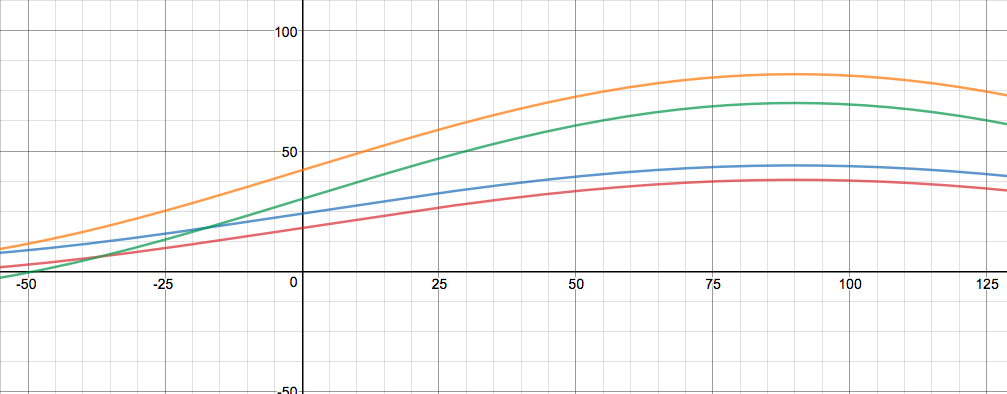

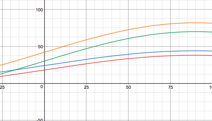

Here is a graph that I made on Desmos. It shows the heights of the different lifts at a given angle. The different lifts are a 4 bar, 6 bar, DR4B, and DR6B.
The x axis is the angle of the lift (in degrees) and the y axis is the height (in inches.)
This is assuming that the angle is the angle of the bar on the top of the tower that it is supported on. Also, the distance between the bars on the tower that the bars are supported on is 6 inches, and the top bar that is supported on the tower is always 20 inches long.
This graph shows how the 4 bars and 6 bars both go up at about the same rate, which is also the same as the DR4B and DR6B. However, what this graph doesn’t show is that each 4 bar and 6 bar each have different starting angles.
But, what we can conclude is that DR4B’s and DR6B’s in fact go up faster than regular 4 bars and 6 bars.
Hope this helps explain the math a bit more.
Red line: 4 bar
Blue line: 6 bar
Green line: DR4B
Orange/yellow line: DR6B
