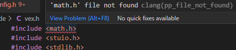

I’m programming in C++ with the Vex Robotics extension on Visual Studio Code. Every single time I make a new project - the “math.h” file is erroring out. I have tried deleting VS code and the Vex Robotics extension completely and nothing helps. Does anyone have any ideas? The error is simply ‘math.h’ file not found - even though it clearly is when I go to my files.
Do you mean that a new project will not build and download to the V5 brain ? or do you just mean that intellisense is showing an error ?
When I download everything fresh - and create a brand new project - the math.h file is erroring out. That is because it has multiple include file errors within it. So I can’t even build or upload because math.h include within the vex.h include is erroring out.

Here is the error. Yes, I do have the C/C++ extension installed - so that cannot be the problem.
Do you have anything else such as clangd installed ?
I have that extension installed. Uninstalling it fixed the “math.h” error - but now when I try to build my project I get this…

Highly unlikely this is the issue, but your next include line appears to be wrong: should be stdio.h but you have stuio.h.
It’s been a long time since I’ve actually seen it as a problem, but there was a time that IntelliSense’a database would get completely whacked for a program, and show linter errors where there were none.
Going back to one of James’ original questions that I didn’t see answered, what is the output when you actually hit the “Build” button. Is it actually throwing an error on math.h? Screenshot or copy/paste of that log output would be helpful.
On line 2, you wrote #include <stuio.h>. Did you mean to type #include <stdio.h>?
