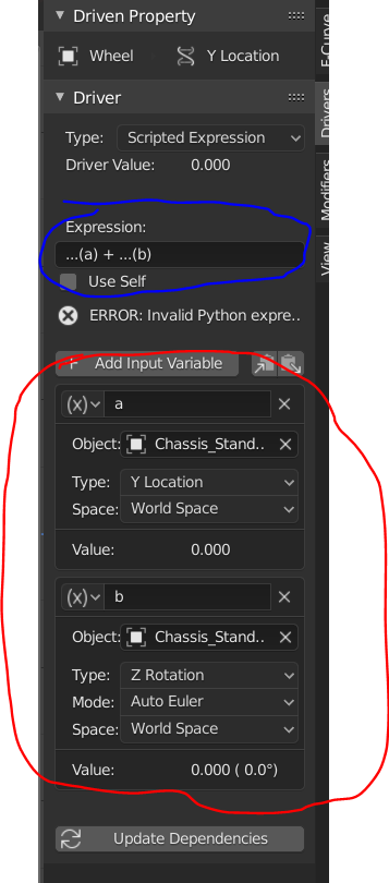

I’m working on an animation project with Blender, and I need some help with a formula.
I have a tank drive, with an all omni-wheel chassis (so point turns). It is 10 inches wide (from center of left wheel to center of right wheel), and 8 inches long.

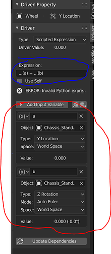

Blender has a drivers feature, which allows you to drive the location/rotation/scale of any object from the location/rotation/scale of another. I need to drive the rotation of the wheels according to the position and rotation of the chassis. The way it works is, there’s box for the formula that drives the driven object and boxes to declare variables from driver objects.
It is very easy to drive the wheels for when the chassis moves forward/backward, but I need help on the rotation part. With a 10 inch wide wheelbase, what formula would I need to use to drive the wheels with the chassis when it turns and moves forwards. I know not many people here use Blender, but that shouldn’t matter. It’s much more of a math problem.
I need a formula to describe wheel rotation when given input values from both the position forwards and rotation
I would appreciate any help that anyone could offer.

a = robot center’s forward/backward position in inches
b = robot’s orientation in degrees (no rotation = 0 degrees, clockwise is positive)
d = wheel diameter in inches
w = wheel rotation in degrees
Left Wheels:
w = (360a)/(pi*d) + (10b)/d
Right Wheels:
w = (360a)/(pi*d) - (10b)/d
Note that each wheel is made up of an independent component. For just turning, you’ll have
w = (10b)/d
and
w = (-10b)/d.
Dennis, there’s probably a better way to do this, I know.
A position and rotation of the robot does not map to a single set of wheels rotations since you can get to any position in many different ways.
A driver would need to know the entire path, which it cannot. You would need to use scripting (a feature built into blender) or find an add-on which can do this.

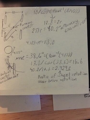

for simple point turns this ratio should work. If we new the actual turning center of the robot then we would need to change the math, but going off the assumption the robot turns around the drivetrain’s center, this should be accurate
Glad to see we got the same answer!
(When you substitute 4.125 for d in my solution, you get w = 2.4242*b :slight_smile: )
