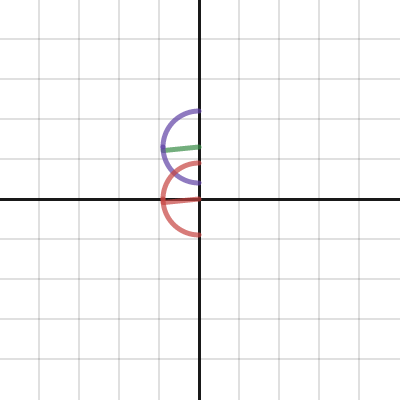

Since both bars are traveling along a circle you can just constrain two lines to the circumference of two circles with the radius of the lengths of the arms.
https://www.desmos.com/calculator/fipjawp6m4
Here is a quick model i made, descriptions of each variable used in it should tell you what they change and by using the sliders you should be able to get the model you are looking for. Hope this helps.
edit: oops, used the wrong variable for one part, fixed now

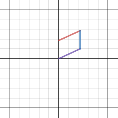

How about this one? You can change the lengths of the vertical and horizontal bars.
https://www.desmos.com/calculator/vuks6zualb
It doesn’t go below the x-axis, but if you want to imagine the lift mounted on a tower pointing down, you could multiply f1 and f2 by (-1).

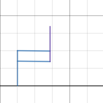

How about this? I mainly designed this to see what heights I can get from lifts of various settings. See the parameters folder for explanations of all the variables. Note that this only really works when L1 and L3 (the lengths of the parallel bars on each four bar) are the same. You can also animate a (by pressing the play button) to see how the lift looks when moving
https://www.desmos.com/calculator/vhfmqs6k3k

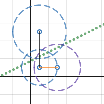

Ok here’s an update with what I’ve got so far. I have the two moving bars ready. I just need to set a fixed length to the right most bar and find a way to set the rotation of the top bar, or alternatively set a fixed length to it w/out control over the rotation.
Here is the link: https://www.desmos.com/calculator/saslsgbdcj
If you have any tips for completing the final stretch of the project, please post them or even modify your copy of the project if you are up for it. Helpful criticism is also welcome.

Ok we are on the home stretch. I managed to set the rotation for the bars off of circles and then find the joint between the right and top bars using equations to find the intercepts of said circles. The only problem I’m encountering so far is that I am using way too many variables, but the deal is, I don’t think there is a way to shorten the equation.
Here is what I have so far:
https://www.desmos.com/calculator/vqvkdyhzxw
I’ll try a few more things to hopefully get it working on my own, but again if there is any suggestion as to how we can get past this last hurdle, please post it, or if you know how to fix it, by all means fix it in your copy and post the link to your copy here.
