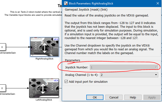

I have tried it, and I am not a fan. As far as I know, the support package for the VEX Cortex was originally made for BEST and more recently brought to VRC with free sponsored licenses for VRC teams.
Overall, the setup is very restrictive. One major feature that I could never get working was partner controllers. By default, the appropriate option is grayed out (adhering to BEST rules), but it is unclear how to enable the option. There is also next to no documentation on anything besides the absolute basics (which are simple enough to figure out just by looking at the example models and playing around).
It should also be noted that there is absolutely no form of realtime communication between Simulink and the Cortex – not even a basic serial terminal, let alone advanced graphing features.
Given all of this, I would have to advise creating your own code (especially in PROS) over using Simulink with VEX ‘support’
