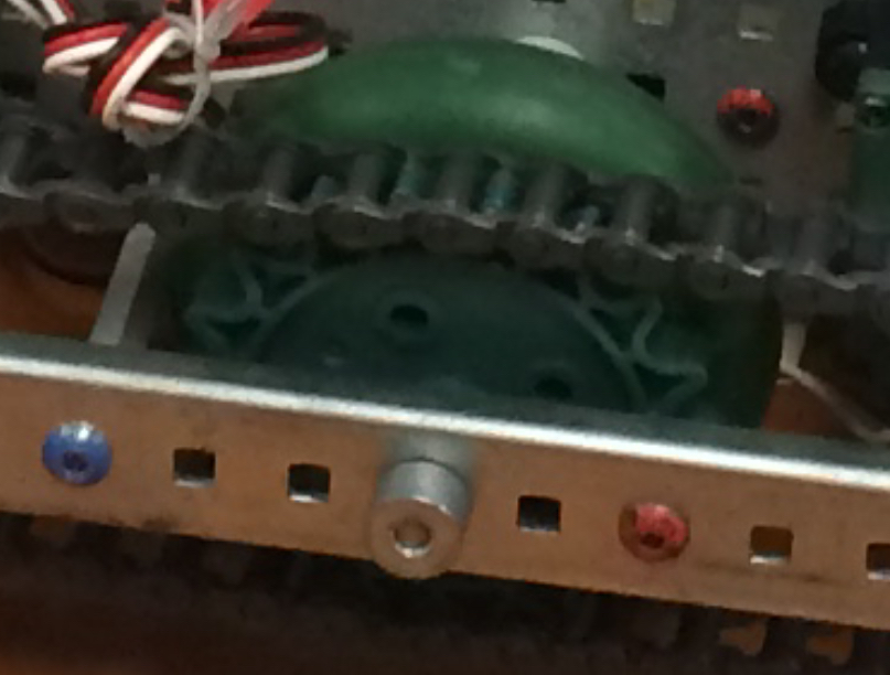

I’m going to ask the thing that everyone will probably want to know - Do you have a picture of the drive?

I have an older picture of our robot I can post but I can’t get an updated one until tomorrow.

by the looks of the picture are you sure that the wheels are actually hitting the platform? We had the same problem because the frame of our base was hitting the platforms before the wheels

no The sprocket act as a wedge to get up. Though the wheels do touch in the back

Sorry I don’t have any better pictures. This was from my robot late-early season. You could use the same idea, but just put the wheels (not contacting the ground while driving normally) at a couple of different places to help you climb. I’ve seen other robots that had a very similar idea that worked pretty well, also.
Edit: That’s a 2.75” wheel there behind the sprocket, if you can’t tell.
