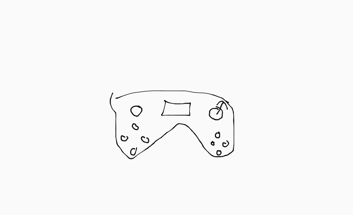

So i’m making a mecanum base with my team and i’m trying to do a diagonal angle like when the left controller is going in the top left angle it would make the base go into diagonal in that angle
like that:
but my code is not working somewhy here is the code:

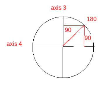

This is because the joystick values at diagonal add up to 180 because it is 90 from each side. The motors can only read up to 100. (I am talking in percents).
So you will need to do 100/180 to find what it needs to be scaled by.

The controller axis can go from 127 to -127 on just one axis.
Let’s use axis 3 and 4 for example.
Axis 3 has the max values of 127 and -127
Axis 4 and the max values of 127 and -127
If you go at a 45-degree angle to the right, and up, the value will be 180.
This is because it makes a right triangle.

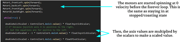

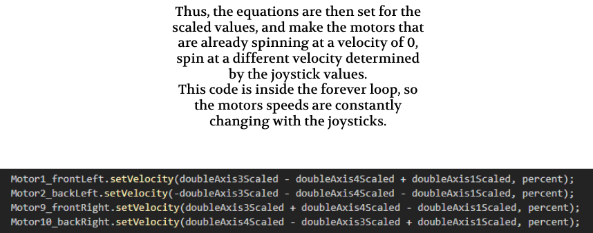

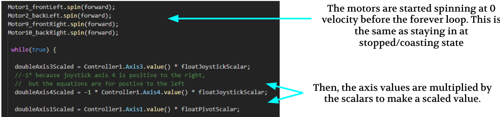

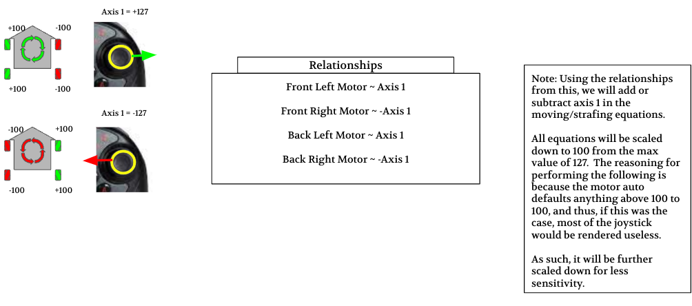

This is what i did kinda. I added pivoting, which is axis 2 for me. I have forwards and reverse on 3, and strafing on axis 4
mmmm i see but does it do the same thing has what i did?
yes, but I can pivot while strafing while moving forwards. It is a very complex movement, but it is fun. I can walk you through the pivoting if you want me too, but it is the same concept, just add or subtract the value depending on the motor setup.

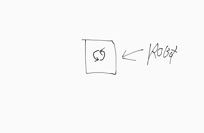

alright but what exaclty is pivoting?
Robot go spinny spin around its center. This slide explains how I did it for my robot.

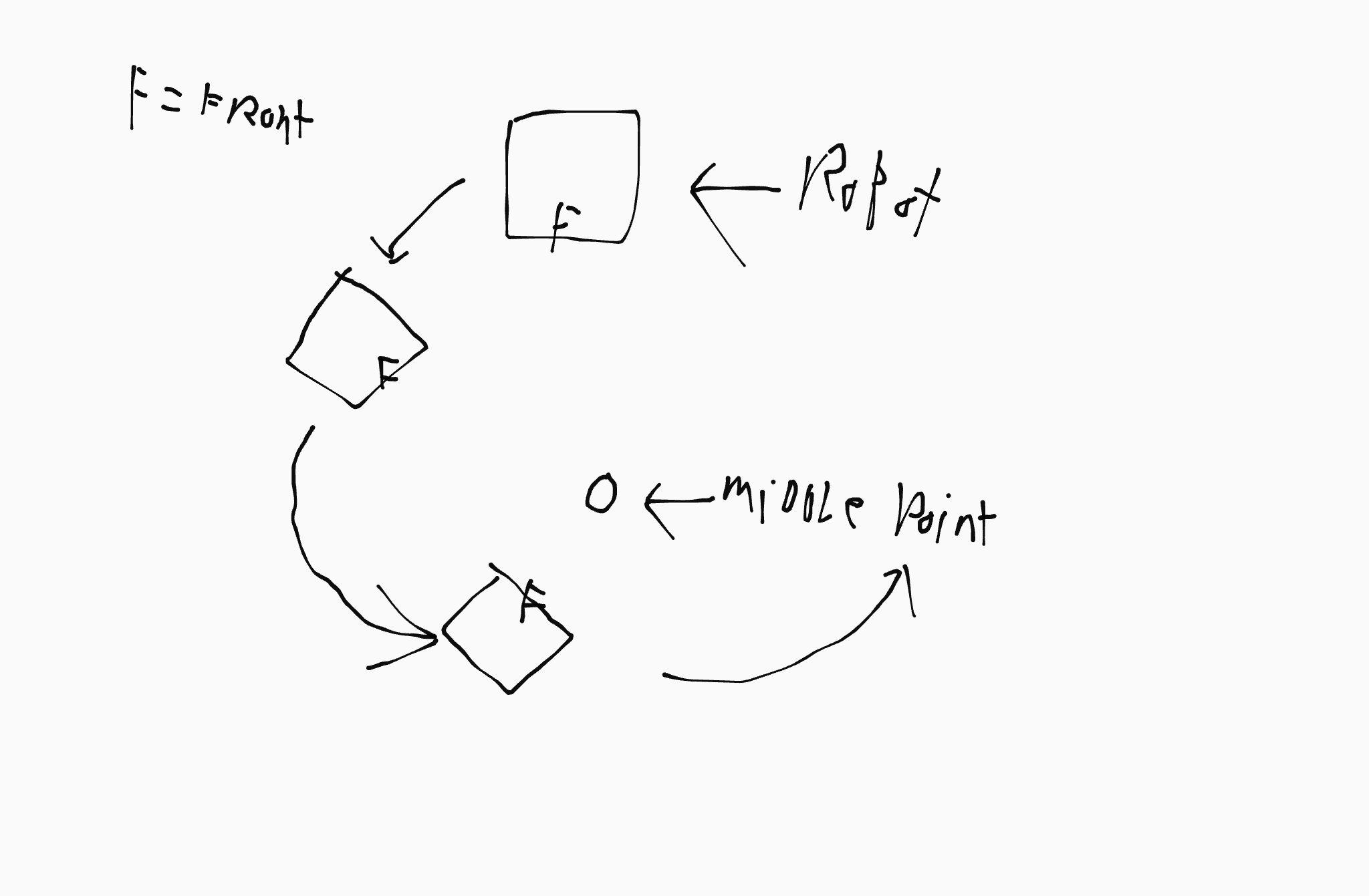

oh yea like turning?
kinda, the technical term is pivot, turn is a gradual movement where you drive forwards or reverse while turning. Pivot is turning in a single spot, or during movement. But they are very alike yes.
is it something like that?
or like that:
