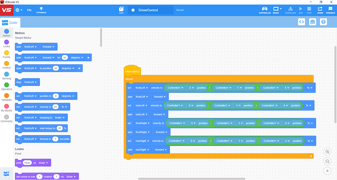

Currently I am experimenting with a mecanum drive/base and have finished building it. Although I am not sure how to code a mecanum base on VEXCode Blocks. Any help would be appreciated

If you look at the Wiki - #33 by technik3k that is forming up, you can see some images and code relating to mecanum drives.
The general concept is that you will combine 3 joystick signals together to give a motor value to each of the 4 wheels. One signal for Y (forward/reverse), one signal for X (strafe) and one signal for W (turn).
If you open the example project for Arcade Left (or Right) you will see how the signals for Y and W are combined on one joystick to control a typical inline drive. You can start with that code, and add the lines needed to give a value to each of your 4 drive motors. To strafe, you will add (or subtract) the horizontal axis signal from the other joystick for each motor.
Typically it would look something like:
motorName = Y signal + X signal + W signal
frontLeft = axis3 + axis1 + axis4
backLeft = axis3 - axis1 + axis4
frontRight = axis3 - axis1 - axis4
backRight = axis3 + axis1 - axis4
If you look at the diagrams in the wiki, the reason for adding or subtracting is there. (It’s possible I goofed them up, so check my work) :slight_smile:
edit: screen cap of one motor with 3 signals:

here ya go
MechanControl.v5blocks (9.9 KB)

Hey this was soo awesome I wanted to ask one question how would I get it drive forward regularly?
what would you mean by that?
like not straffing the entire time
Odd. It works for me, so it might be an issue on your end,
