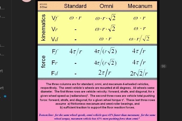

I found this chart on an old post but strafing with mecs moving the robot at the same speed as a normal wheels feels wrong to me, would be apriciated if someone who has them could confirm.
Screenshot 2023-07-27 6.26.25 AM

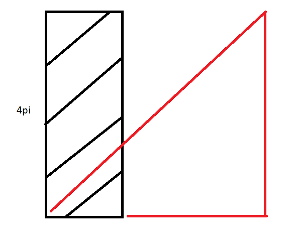

The graphic is correct; I’ve come up with a reasonable visual proof.
Imagine unwrapping a mecanum wheel’s outer surface and laying it on the ground. It works the same, just not wheel shaped. This is the black rectangle with a length of 4pi. The lines sort of represent the rollers.
Then imagine sliding the floor sideways underneath the unwrapped wheel. You can imagine that sliding the floor sidways 4pi inches would push the wheel forward 4pi inches, since the line that defines this motion is at a 45 degree angle. If this were a wheel, and not an unwrapped wheel, 4pi inches would correspond to one rotation of the wheel. So rotating the wheel forward once would slide the robot sideways by the circumference of the wheel e.g. the ratio between forward motion and sideways motion is 1:1.
Usually, mecanum wheels strafe much slower than they travel forward (and they do travel forward at the same speed as omnis if built well :wink:) due to inefficiencies, not math.
The ratio is sqrt of 2.

@2775Josh. Based on this graphic wouldn’t the robot move sqrt 2 times faster in the diagonal direction because it goes along the diagonal line which is sqrt 2 times as long?
Mecanums move slower by a factor of sqrt2 when going diagonally (as mentioned in the graphic you sent).
