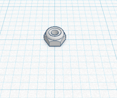

Thankyou! do you know a way that I could simplify the file? My software says it is too complex to load I did try and download the STEP file and convert that, but for some reason i think it turned into a nylock nut? idk, I tried to re import that to make sure I didnt click on the wrong file but it still turned into a nut.

tinker cad does not support complex shapes(its only for starters)!
Use autodesk fusion 360 if you really want to do this
Its only a nylon nut because thats the only part that tinkercad is powerful enough to load

If you’re hard-set on using TinkerCad, you will need to use some form of intermediate program to convert the files. You could try using Blender for this, I’ve found it runs decently on weaker computers. I think if you use Blender to convert the STEP file to an STL, you should be able to import that into TinkerCad without issue. I’ve been informed this isn’t the case. I honestly don’t know if there’s another CAD software that would work for this.

i cant use blender anyways. I use a chromebook and cant currently update to anything nice like windows) and was unable to install Blender and the rollapp version of blender didnt work. I am trying out sketchapp now, but it isnt handling the mecanum file too well. My teammates though have the proper software and know a decent amount about CAD, so if i desperately need a file converted to use, I could have them do it for me. I also am pretty sure one of them uses blender.
