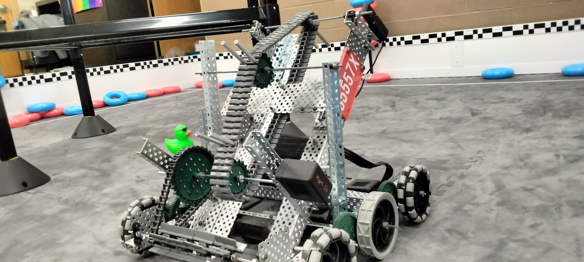

Meet robot 65557X!
May I formally introduce you to: the S.S. DUCKY!!!
Where’s the MoGo Mech?
Oh! it’s blocked by the stake. here it is:

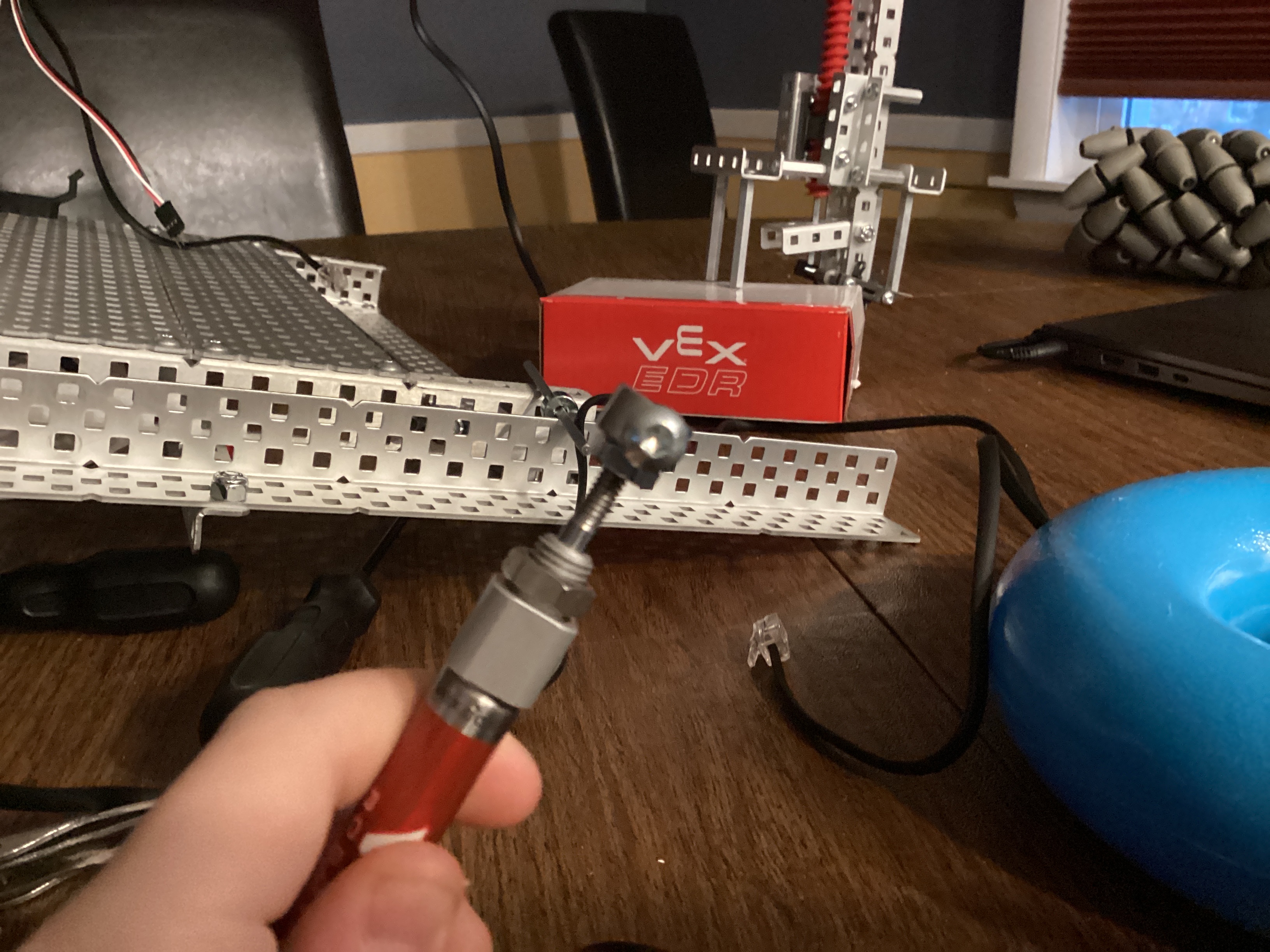

I like the name but why not use shaft collar in to star drive screw trick? I’ll show you what I mean in a sec
Because I’ve never heard of it? I don’t see the appeal. It seems useful, but takes up more space.

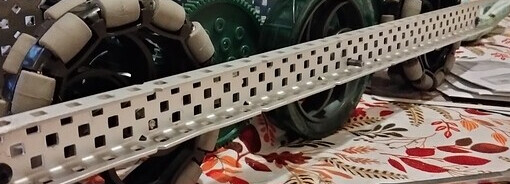

On your drive I would recommend having another c-channel on the outside for extra protection and 2 points of contact
We added that, just after these photos were taken. Look:
I would advise you add bearing flats. Bad things happen without bearing flats.
On what? We have them on basically everything where you would need it
I think what @Entropy is referring to is the lack of bearings on the outside channel on your drivetrain. Since the axles on your drive are pretty much constantly moving, without bearings the axles will slowly but surely grind out the holes in the channel to the point where it serves no structural purpose anymore.
Maybe the bearing flats are on the inside
How do you align your mobile goal?

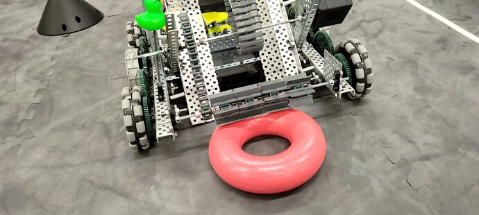

If rings go over the conveyor belt, make sure to make your hooks actual hooks instead of just standoffs
Add cross-braces (C-channels running all the way across the drivetrain)
Plates are okay for things that you want to bend or don’t care about strength

If they are on the inside side of the channel, they are not attached by screws, zipties, or any fasteners, which is essentially the same thing as not having them at all.
Brain on the underside, S.S is like a ship
It does have cross braces, the rings go along the underside of the belt on a ramp, and yes, it does have bearing flats on the inside
