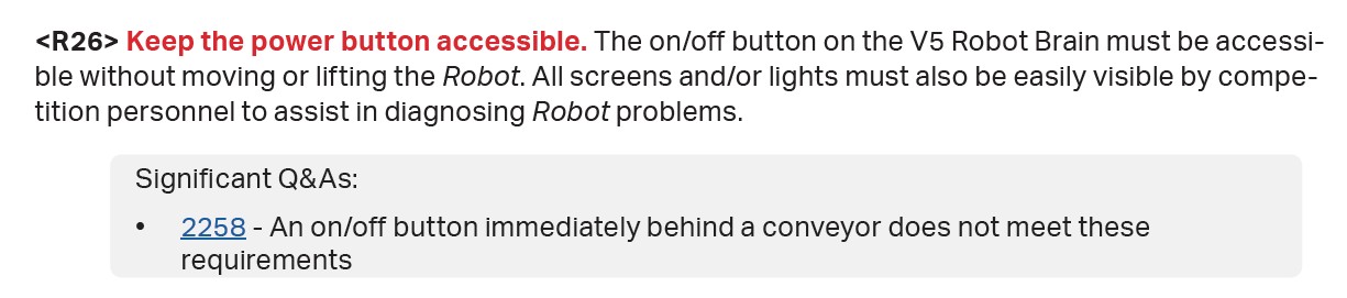

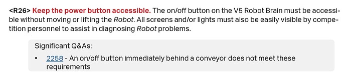

Possible violation of <R26> with brain on the underside

You just reach under the mogo mech to turn it on. I made sure it could be turned on and off without flipping it.
was about to post the same thing… looks like a definite violation of R26 that would keep it from passing inspection at a tournament. Easy enough to fix before then.
It is not behind a conveyor. It is facing the mogo mech, right beneath it. It is not hard to reach in any way
Oh wait, nevermind. Didn’t read the fine print
it doesn’t matter that you can easily reach the button. You also need to be able to see the screens and actually see the button. Here is a thread from just this year discussing the same idea.
I don’t believe that this specific question has been addressed in the Q&A, but here is the link to the brain being inside the conveyor…
the last bit of the response is…
“Teams and volunteers must be able to troubleshoot and easily turn off a Robot. We take safety rules with the utmost seriousness, and give most of them precedence over just about everything else. In a safety-related situation, volunteers must be able to safely and easily cut power to the V5 Robot Brain without having to understand the intricacies of the specific Robot and its operations.”
That logic should apply here. I’ve inspected many robots at many competitions and I would not pass it as is. You could keep it as is, but be prepared to fail an inspection.
Always reed the fine print, failing inspection would stink and so play towards the side of safety.
Don’t worry, I moved it. It was a hassle, tho.
