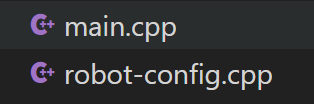

You might have declared them using the setup thing in the top right corner and declared it again in main.image
You need to declare it in robot-config only using this : image
I narrowed down the issue:
It is when I try to make a global object of a class that I declared in another file. I included this file in main though.

The default constructor works but the constructor with two parameters does not. (By using the constructor with no parameters, I do not get the error)
so all your constructors are using instances of sensors that probably have not been created.
There’s no guarantee for the order in which the global constructors across files are called (generally it’s alphabetical order) so constructors for global objects in main.cpp can be called before robot_config.cpp. You use inertialSensor, xEncoder and yEncoder before they have been initialized, that’s probably the cause of the error.
Not sure why that would be, I’ll setup a test later.
move this to the end of robot_config.cpp then declare in a header so you can access globally.

Do you think it would be better if I passed the inertial sensor and two encoders as parameters in the constructor?
That didn’t create an instance, you declared a function returning instance of Position class.
probably will have the same issue unless they are created in the same file (and before) you create the instance of the Position class. The root cause here is again the use of Brain.ThreeWirePort before it exists.
you could just skip those sensors in robot_config.cpp and create them inside the Position class.
