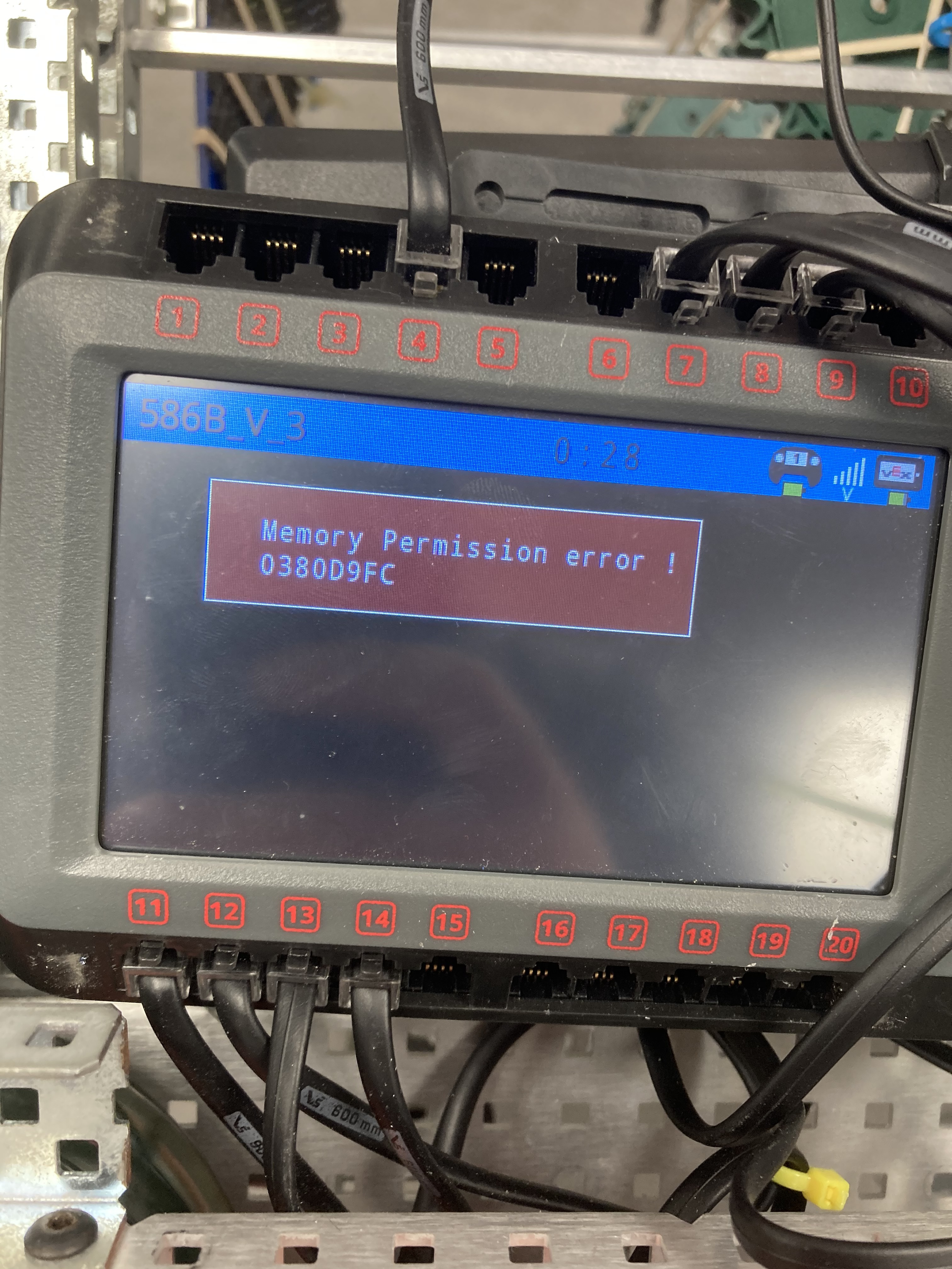

Memory Permission Error! 0380D9FC
586B_V_3.v5python (7.5 KB)
I think you’ll have to update your brain firmware. It worked for me
It works for a little bit at first, but it eventually throw that error. I’ve tried it on two different brains and it still throws the error. Also, I did check and the brain is currently up to date.
Move the controller button event registration outside of your while loop.
every time you call
controller_1.buttonL1.pressed
you are registering a new event handler on that button, you run out of resources almost immeadiately and cause some type of issue with the Python VM.
