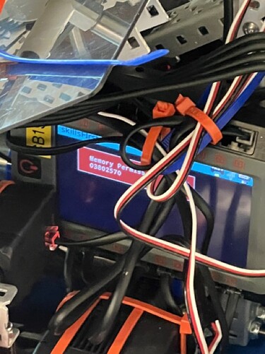

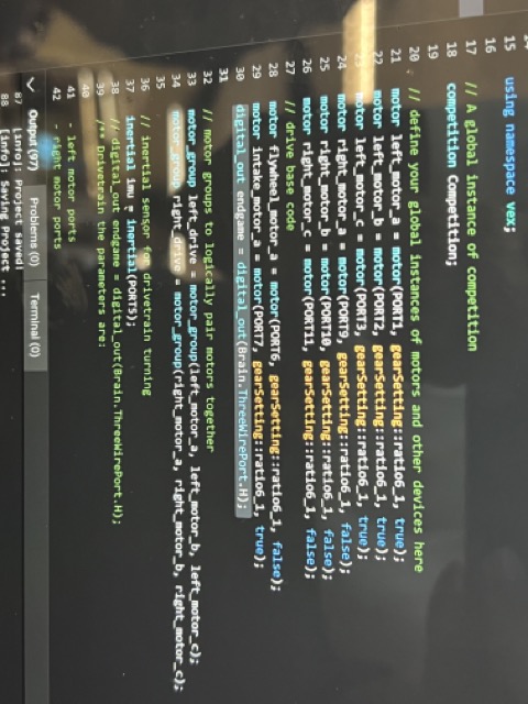

So there’s an issue occurring when a team I’m mentoring is using their pneumatics. The digital_out is defined globally along with all the other devices. However when the program starts, it immediately gives a memory permission error. I traced this to the line of code where we define that endgame variable. This behavior does not occur when we defined the endgame variable in separate scopes in autonomous and usercontrol. Is there a reason for this?
I assume the usual problem, you are using Brain.ThreeWirePort before it has been created.

In theory you could just change the default robot-config.cpp filename to aaaaaaaarobot-config.cpp, but somehow that seems a bit inelegant.
