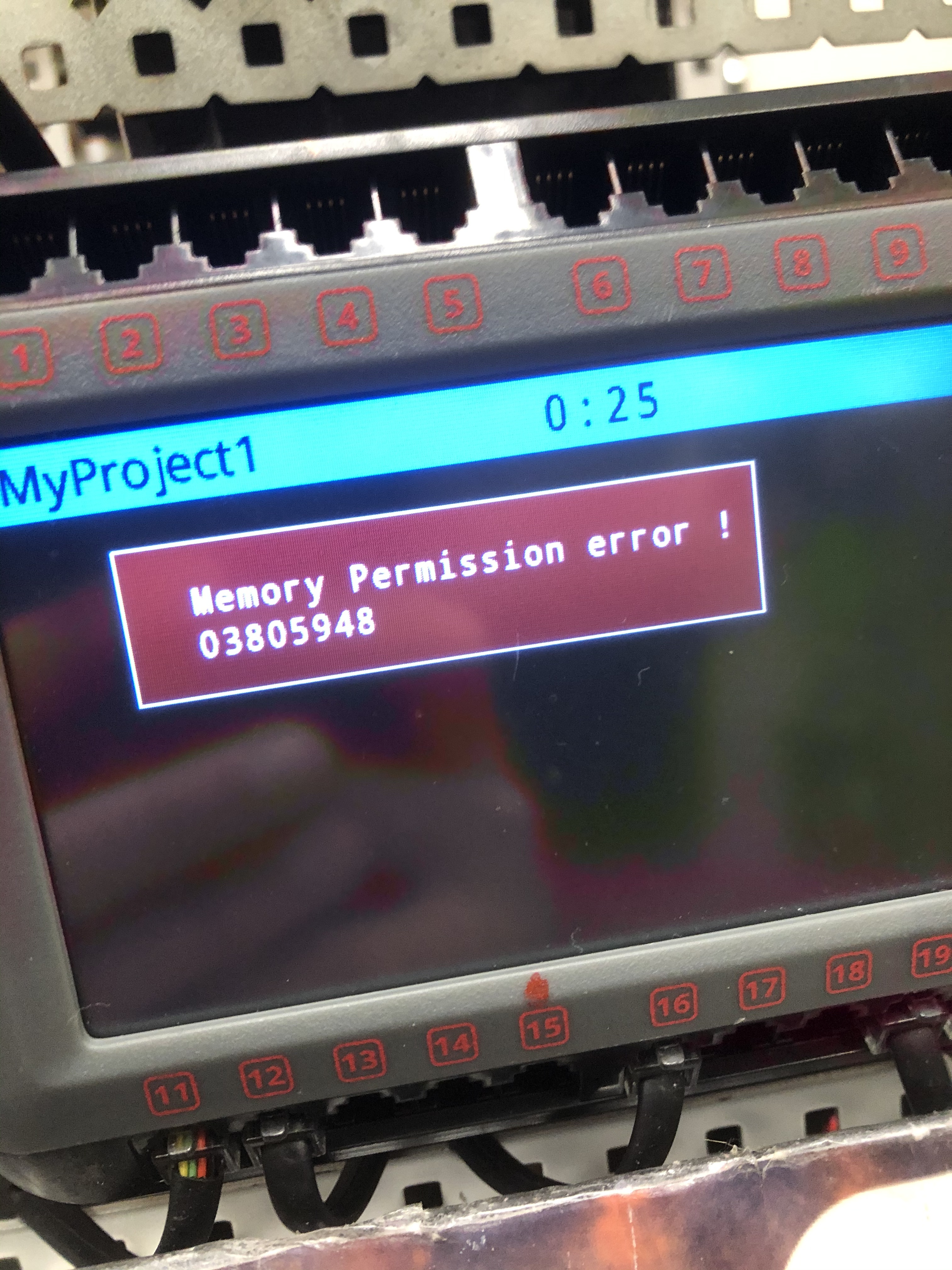

So I have been getting this error every time I try to use a program that I downloaded onto the v5 brain. I checked if it was the cortex. Nope. Checked if it was the computer. Nope. Checked if it was the cord. Nope. I am very confused. I even copy and pasted my whole program onto a new project and tried again and still got it. I don’t know what is happing but I kinda need help.image
IIRC this is a memory leak in your code, it would be helpful if you could post your program here (remembering to wrap it in [code]...[/code] tags for formatting).
yea, it’s an issue with the code, usually a bad pointer or trying to use an instance of a class before it’s been created.
Could I personally just maybe just send it to one of you. I rather not someone just go on this thread and plug and play.
  1. nobody is gonna steal broken code
  2. I volunteer as code reviewer
Well I can’t even post it right now because the WiFi is out and the code is on my computer. If you are confused I am on my phone with cell service
Excuses… excuses…
Once my internet goes back up I will post it
Oh and you saying, broken code. I probably just deleted something on accident or something and had no idea. And you saying people wouldn’t steal it. Well when it is fixed they code. But I mean it is pretty simple so not a big deal.

edit: ok, you figured it out while I was typing :slight_smile:
It’s probably this
vex::limit LimitSwitchA = vex::limit(Brain.ThreeWirePort.A);
vex::limit LimitSwitchB = vex::limit(Brain.ThreeWirePort.B);
often the issue is that brain is not created when main.cpp constructors run
see this
Ok, Yah I am trying to learn how to use sensors this year and forgot I even put that in there.
So how could I fix that problem or properly code it
Did you read the post I linked ?
triport ThreeWirePort = vex::triport( vex::PORT22 );
vex::limit LimitSwitchA = vex::limit(ThreeWirePort.A);
vex::limit LimitSwitchB = vex::limit(ThreeWirePort.B);
the underlying issue is that main.cpp runs its constructors (ie. makes the devices etc.) before robot-config.cpp (an unfortunate choice of name on someones part, we should have started it with a letter < m), although the order things run is not defined and so could technically be different.
Well I did read it but I was not smart and typed before I even looked at it. Sorry about that. But I am confused on why you would put a actual port on the top line of code/above the limit switches. Because I am not using a triport extension
This creates an instance of a 3wire expander. We have one inside the V5 brain , that’s the one on PORT22. You can now buy them and attach to any external port.
When the brain instance is created we do this as a convenience for you as well. So when you use Brain.ThreeWirePort that’s an instance we made automatically, but if the brain instance has not been created then Brain.ThreeWirePort is also not available.
Once you have an instance of a 3wire expander you can create switches, potentiometers etc. using specific ports on that device called A, B etc.
so these lines
make the limit switches using ports A and B.
Ok I think I understand now. My only thing is do I have to “link” the ports together with port 22 or can it be any.
The V5 brain has 21 external smartport connectors, they are the ones you attach motors etc. to.
The A-H ports on the side of the V5 brain are part of a 3wire expander that is connected to an internal hidden port22, so you have to specify that as the port you use
(unless your switches really are connected to one of these)
Anyway, has it fixed your memory permission error ? This was just the first thing I saw, there may be other issues.
