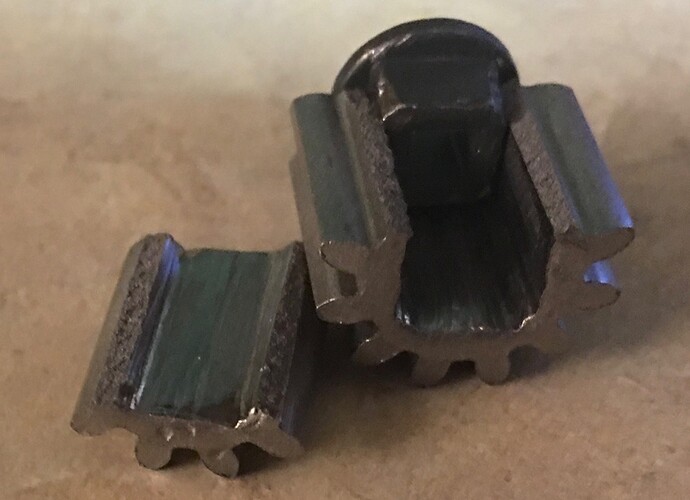

Here’s a picture that brings about the question:
My daughter’s team opened a new box of high strength gears, took an insert, and placed it in a pinion. This is the result.
Those are the wrong inserts for pinion gears, which come with their own special insert. Here is a photo of the gears and inserts:
