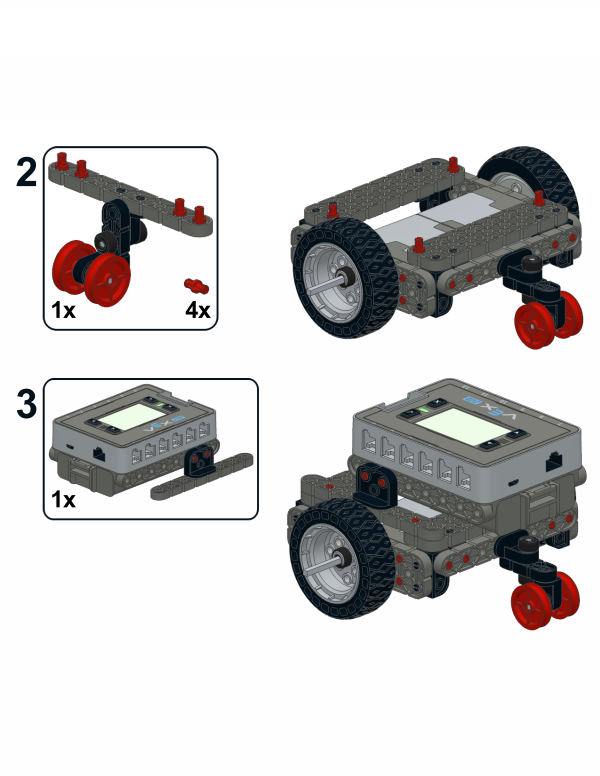

A lot of showcase robots demonstrate amazing construction and programming skills. I like to look in the opposite direction, and put together, simple robots. Here is my little design called miniVEX. It takes just a few minutes to build and is designed to get students with a usable base quickly so they can start to learn about programming. There are plenty of places to add attachments (sensors / claws etc) and I highly encourage students to make modifications once they get a basic feeling for how it all goes together. You can download full Building Instructions from my website (Big thanks to Philo for the LDRAW parts) and if you do use this design, please let me know as I love to see how far and wide my little robot designs go :slight_smile:

I’m going to be building this pattern this week and putting the caster that Art posted and see how it works together. :smiley:
Thank you, Damien for sharing this.
Where is the castor Art posted? It’s the one thing I’m not happy with on my design.

Nice :slight_smile: Unfortunately it isn’t in the Starter Kit so I don’t want to use it for my miniVEX design. Am always open to any suggestions on how to make a simple castor :slight_smile:

Art, the castor was too tall so I had to use the 2X size instead of the 2.5X. It still had the clearance so the wheel turned freely and it really worked well with Damien’s design.
Damien, I had to add some additional braces on the front and back. It didn’t seem sturdy enough for me so I added some more. Also, I am going to have to add some stand offs and additional 2X8 foundation pieces over the axles as I found that they were walking out of the motors (if you look on the website, VEX has put out some guidelines to follow to keep axles secured.) I will take some pictures of the changes I made and post here if possible. I know that my version will probably not meet the criteria you set down of making the 'bot from the starter kit so I apologize for that in advance. I can tell you right now though is that your robot is very robust and quick in response to the controller.
