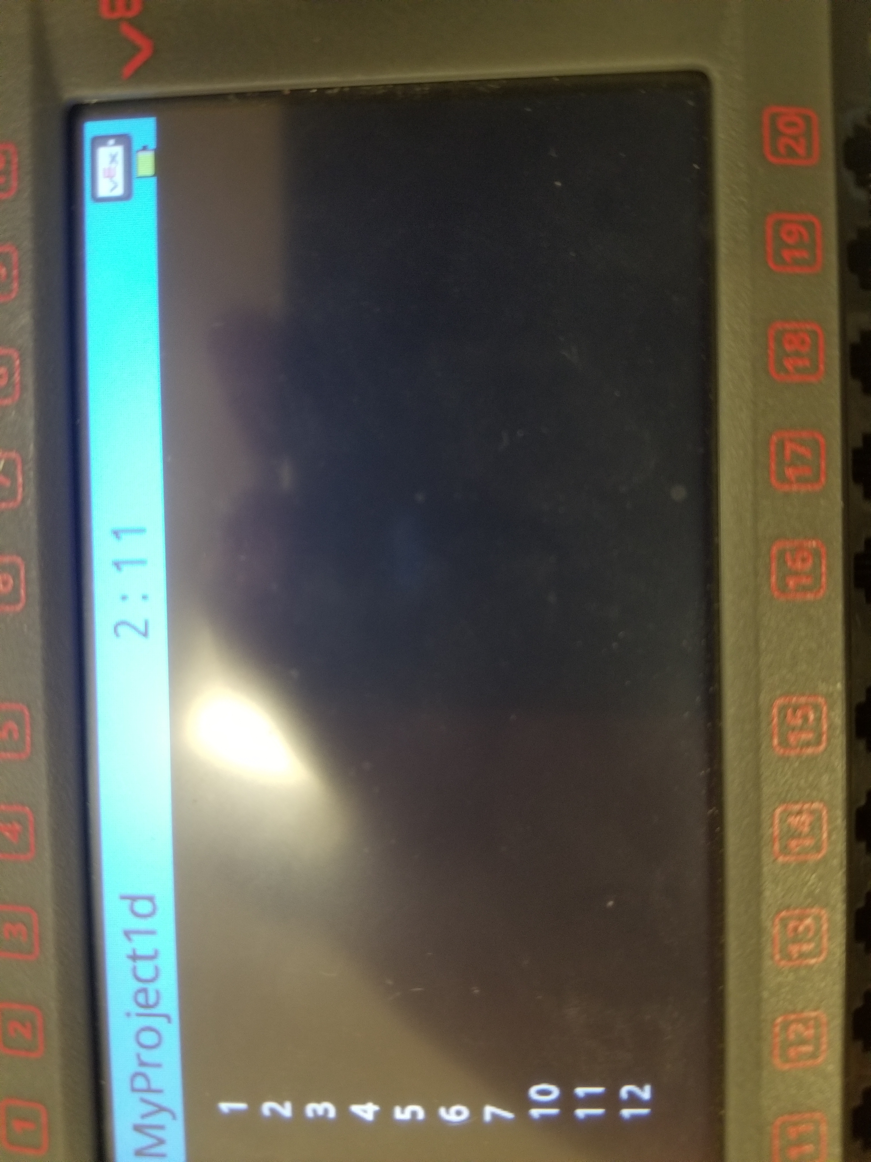

I’ve encountered a peculiar problem when printing things on the Brain. I’ve tried to print the number 8 and 9 on the screen, but 10 and 11 are printed. It seems that the brain skips 8 and 9 since the sequence continues as usual.

This is the result from the code above:
20191003_163031
Er, that’s because you are asking to print in octal. Use %d as format string.
